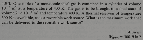

I ask because in the context of the following conundrum given to us by Callen in his classic thermodynamics textbook:

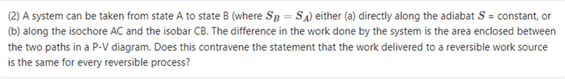

(2) A system can be taken from state A to state B (where ##S_B= S_A##) either (a) directly along the adiabat ##S## = constant, or (b) along the isochore AC and the isobar CB. The difference in the work done by the system is the area enclosed between the two paths in a P-V diagram. Does this contravene the statement that the work delivered to a reversible work source is the same for every reversible process?
The answer here -- I think -- is that there is no way to reversibly (with respect to the subsystem+surroundings --i.e. subsystem+whatever composite system you consider it as part of) take the primary subsystem to the final state as in b). Perhaps this answer is wrong though, and there is some separate reason that (2) above does not violate the so-called Maximum Work Theorem.

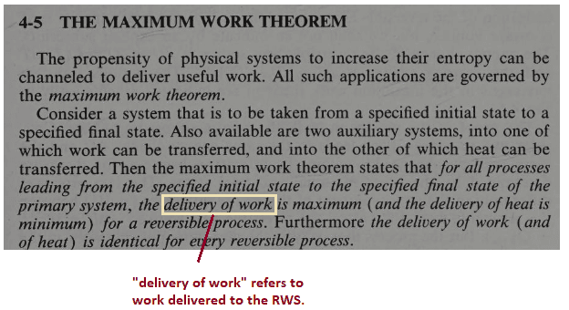

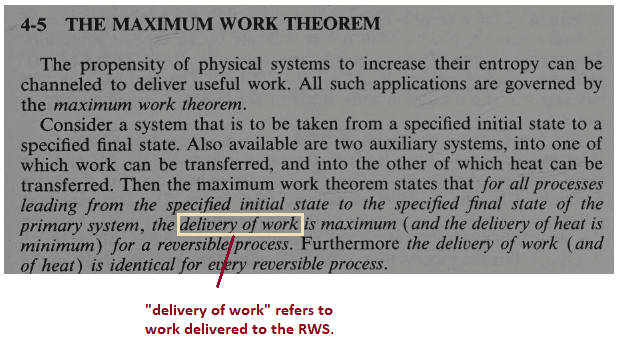

Look at Callen's statement of the maxium work theorem:
The theorem is talking about the net work delivered to the reversible work source (RWS). This work will be the same for all reversible processes that use the same reversible heat source RHS. It is not talking about the work done by the subsystem ("primary system"), which can differ for different reversible processes working with the same RHS.
Consider problem 4.5-1
The answer doesn't depend on which particular reversible process you choose to take the gas from its initial state to its final state. You don't need to pick a specific reversible process to work the problem.
But if you do consider two different reversible processes that take the gas between the initial and final states as described (and that use a thermal reservoir at 300 K), then you generally find that the work done by the gas is different for the two processes (even though the two processes must deliver the same work to the RWS).
For example, if you choose a reversible process such that the state of the gas moves along an isotherm, the work delivered to the RWS will be ##300 R \ln 2##. I get that the work done by the gas is ##400 R \ln 2##.
If, instead, you choose a reversible process such that the gas first goes through an isochoric process that halves the pressure and then goes through an isobaric process that doubles the volume, the total work delivered to the RWS is still ##300 R \ln 2##. But I get that the total work done by the gas is ##200 R##.

I think this gets me very close to understanding. I asked about (2) in my OP on another site weeks ago and, ironically, the answer only came to me yesterday (see my edit here). Does that edit make sense to you? In the specific example you gave, to confirm, is the "delta" of work delivered to the RWS (above or below ##W##, the work done directly by the primary subsystem) effected using the heat extracted from the primary subsystem (and "channeled through some auxiliary subsystems")? That is, in the isothermal case for example, some of the work done by the gas needs actually to be redirected as heat to keep the gas isothermal?
