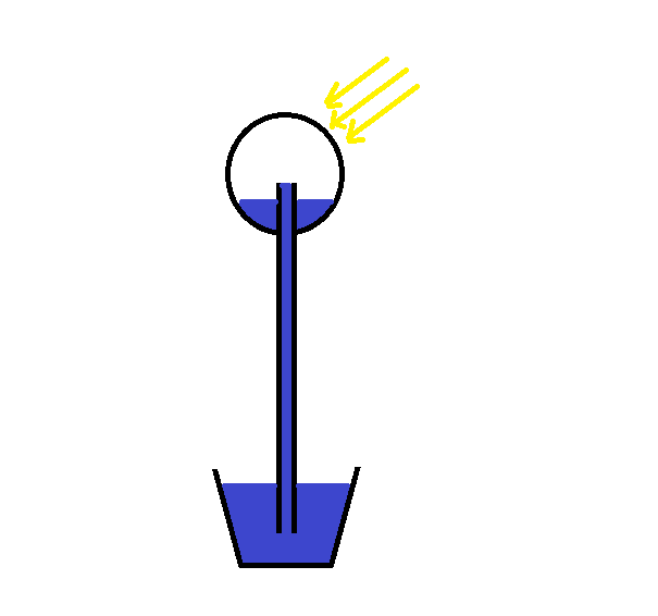

It depends on the volume of water you need to lift, the number of time cycles you can lift the water in, whether these cycles constitute a pump, and so forth. Does "pump" mean moving parts? You can create a solar "pump" without having any moving parts except for gate valves, maybe a check valve. If this is an exercise, saying the system can remain closed, and the lifted water doesn't have to be utilized, it simplifies things even more. I am limited as to what image edit software I have available, but here goes:
The water is contained in the bucket at the bottom. The top has a chamber that is sealed to the standpipe, with the top of the standpipe above the bottom of the chamber to allow for catchment of overflow. With a limited diameter not as much vacuum will be necessary to lift the water based on mmHg/in2, but this will increase the amount of cycle times required.
Paint the upper chamber black. During the day, the upper chamber will heat, forcing air out and bubbling out through the bottom of the standpipe. In the evening, the air will contract, atmospheric pressure will force water up the standpipe to be collected in the catchment basin, provided the difference in heat is great enough to differ with ambient air temperature.
EDIT: If you need to collect the water from the catchment basin for use, I'm sure you can figure out from here how to add the gate valves to ensure vacuum loss isn't created, etc.
