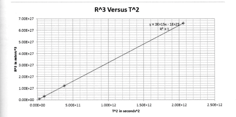

But i am rather looking to do something like this;
Kepler's third law for example, it can be graphed as shown in the picture.
I want to do something like that to form a linear relationship rather than graphing the functions themselves if you get what i mean.

Stanley_physics said:
A straight line.
Right.
Yes, I believe I understand what you are trying to do.
Look at your post #9. You have a function of y on the left and a function of x on the right, and a linear relationship between them.
But in that equation, there are no unknown constants. More generally, you do have unknown constants that you are trying to determine by graphing. Clearly it is no use choosing the f and g functions in such a way that they contain unknown constants, because in that case you would not be able to plot the values of f(x) and g(y).
In your post #9 equation, this presents no difficulty if any of the 81, the 23 or the 7 is really an unknown, but it would be a problem if the 4 is unknown.
