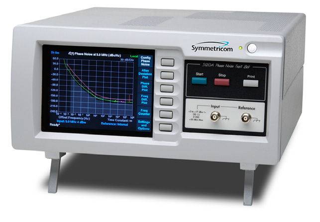

I have to devices in communication with modbus protocol. Master is PC and slave is compressor(100ft line,RS485 standard, modbus RTU protocol). I have to build a setup which will show how much the error in communication. I am coupling some white noise to the line and some burst signals too. I could see error has happened in communication from communication log file which is getting from the Omnimbt software that I am using in master. But instead of this I need to get the BER(bit error rate) and show persons who will be monitoring the performance of modbus communication. Can anybody suggest some possible ways for doing this?

My doubt is how to determine the error, whether by comparing the signal with noise and without noise coupled as we can see in the noise analyzer(ref:figure below) or by determine in bit level comparison(BER)?
