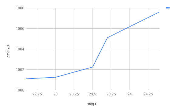

Thanks for the steps jtbell appreciate it. I did exactlt as you specified and I can get the scatter chart but the x-axis is always missing. I attached pic of what it looks like. Its just random numbers. Thanks for any more help

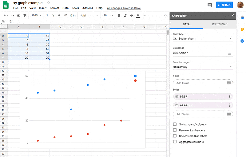

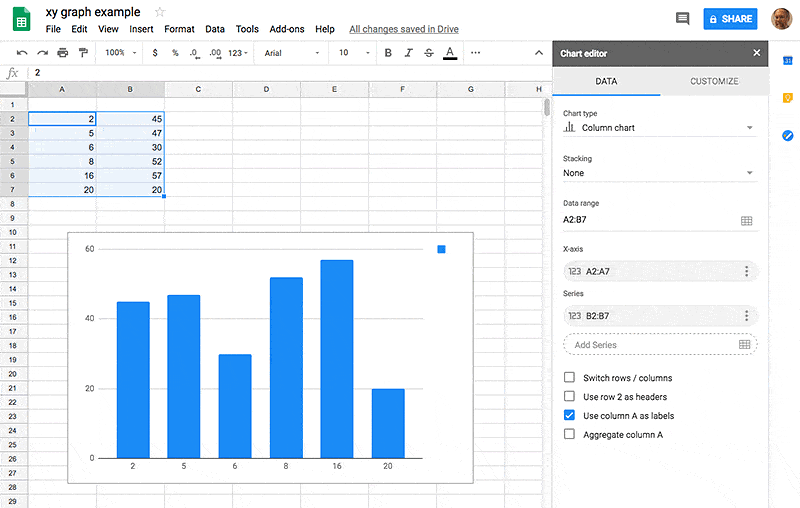

I tried to copy your data by reading the x and y values from your graph. Here's what I got immediately after choosing Insert --> Chart:
Then after changing it to a scatter chart, without touching any of the other settings in the chart editor:
As you can see, I have both x and y axes, and a single set of points. In the chart editor, there are ranges for "X-axis" and "Series". I bet you have a blank "X-axis" and two "Series".
[added] Aha! I deleted the "X-axis" range in the chart editor, and added a second "Series" with the range A2:A7:
The graph looks like what you have, except that the colors are switched. If you have something similar in the chart editor, try deleting one of the "Series" and putting it in the "X-axis".

Thank you again for this help. I finally found out that if I select data columns in separate steps then it will plot the points and plot line.
Im trying to plot pressure vs temp to extrapolate value for absolute zero, but the graph looks pretty bad with the values i got from lab. I think I should repeat lab
