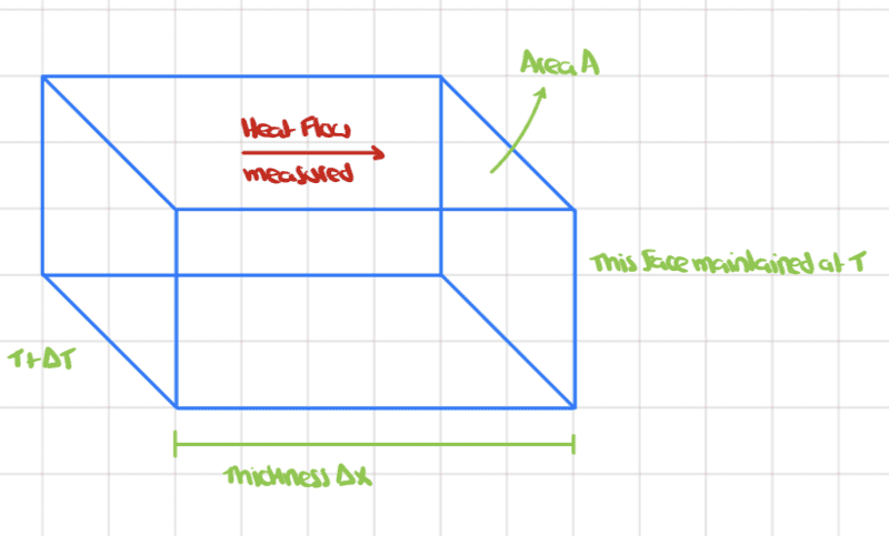

How exactly does this experiment to measure average thermal conductivity of a metallic slab work?
Heat conduction is the transport of energy between neighboring volume elements in a material as a result of the temperature difference between them.
The "fundamental law of heat conduction", as it is called in the book I am reading, is a "generalization of the results of experiments on the linear flow of heat through a slab perpendicular to the faces".
Pictorially, such experiments do the following
The blue rectangular box represents a slab of a material of thickness ##\Delta x## and the area of the side faces is ##A##. One face is maintained at temperature ##T## and the other at ##T+\Delta T##.
The heat that flows perpendicular to the faces for a time ##t## is measured.
The same experiment is repeated by keeping the material the same and varying ##\Delta x## and ##A##.
These experiments lead to the following result
$$\frac{Q}{t} \propto A\frac{\Delta T}{\Delta x}\tag{1}$$
which is approximately true for finite ##\Delta T## and ##\Delta x## and rigorously true when these are infinitesimals.
In this limit, we obtain
$$\frac{dQ}{dt}=-KA\frac{dT}{dx}\tag{2}$$
where the ##dQ## is an inexact differential (I don't know how to write the correct symbol in latex).
The derivative ##dT/dx## is the temperature gradient, ##K## is the thermal conductivity.

zenterix said:
The only thing measured is the "temperature difference". This temperature difference seems to be that between the two metallic faces.
No. The temperature difference is the difference between the readings of the thermocouples that are placed distance ##L## apart. I wouldn't place the thermocouples at the ends of the block where the heat source and sink are because you are likely to get erroneous readings.
zenterix said:
Does it involve also measuring the temperature difference of the water?
Yes, you need to do some calorimetry to find out how much heat enters the water per unit time. The equation for ##K## assumes that no heat is lost as it travels from one end to the other.
Also, you should not record any measurements until you are sure that the steady state is reached. How are you going to figure out when this happens?
