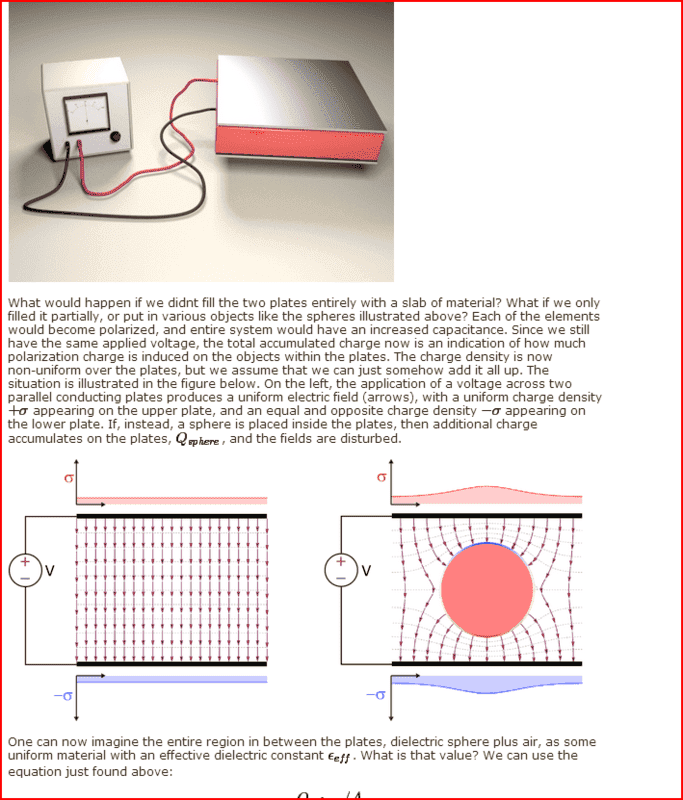

Thank you for your answer. Basically, by asymmetric capacitor I mean, like two parallel plates as electrodes and the dielectric be a sphere, things like that.

Sounds like you will likely need to use numerical methods and FEA software to do your calculations. Which simulation packages are you familiar with so far?

I agree with @berkeman. For something like this you will need to get some FEM modeling software capable of simulating electromagnetic or electrostatics, depending on the frequencies you are interested in. There isn’t a feasible way to do these calculations by hand.

In the mean time, are you just wanting to estimate the capacitance of such a capacitor? What physical size (ballpark) are you looking at? How big are the plates and their spacing, and what are the diameter of the sphere and its dielectric constant?
Depending on what kind of accuracy you need, you can estimate the capacitance of a capacitor like the one on the right shown in the figure above. You could start with just ratioing the volume of the sphere with the volume of the capacitor to get a ~30% estimate of the capacitance. If you need a better estimate than that, you could write your own Excel simulation to probably get it down to about a 5% accurate estimate, I would think...

While FEM analysis would indeed yield the correct answer, one might try simply using a parallel plate capacitor with the volume averaged dielectric for an approximate answer. For relative dielectrics in the 1 to 4 I would expect reasonable estimates for capacitance. Just a thought.
