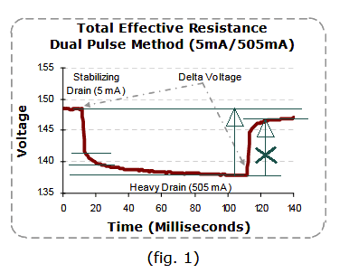

Load regulation tests effectively measure any voltage source ESR whether the load loss is 1% or 50% or 100% (short circuit pulse test) Although there is more than one effective C in batteries from double-electric charge layer effects. Thus there is more than one Time constant T1=C1*ESR1, T2=C2*ESR2 so the duration of the x% pulse must be varied to capture at least two. THe load and unload duration of current affects both measurements of the voltage drop and recovery voltage (steady state) also tells you about these distinct values.
The slope on battery CC discharge tests indicates the validity of this. Although most users just want the a quick test ESR on full capacity after steady state. ESR does rise sharply below 10~20% SoC and ESR will have a shape in BODE plots but can be estimated with different current pulse durations. Thus the value will be different from DC to 1MHz.
This is energizer's method which just uses a 100 ms load test using a heavy drain of 505 mA with preload of 5 mA. which is quick to measure but may differ from your method.
I see this plot in an Energiser technical bulletin which gives an example calculation leading to an ESR of 214 milli-ohms. I presume this is typical for non rechargeables ? Rechargeables (in my limited experience) are nearly an order of magnitude better. Maybe 30 to 40 milli ohms on tests I have conducted on Ansmann (2850 mA hr) cells and Varta (2100 mA hr) AA cells.

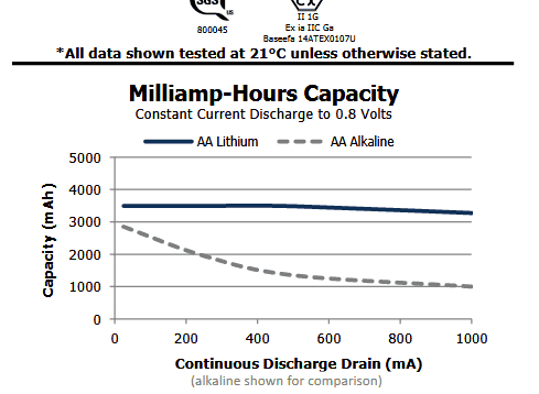

This shows clear difference in degradation of mAh capacity with Alkalines and Lithium non-rechargeables.
Your Ansmann (2850 mA hr) and the Varta (2100 mA hr) AA cells are both NmH rechargeable and indeed have low ESR with some hybrid technology.
IMHO , if you buy in bulk. Alkaline non-rechargeables offer competitive mAh/$ economy as long as the load is not excessive drains in less than 2 days of continuous use. Otherwise with continuous drains, they degrade significantly in mAh capacity as shown above from Energizer https://data.energizer.com/pdfs/alkaline_appman.pdf
