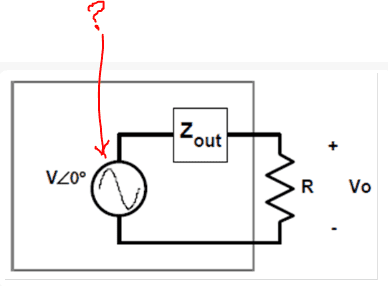

Given a sinusoidal voltage source attached to a load, like the following,
I want to get both the resistive ## R_o ## and the reactive ## X_o ## components of the output impedance ## R + jX_o ##. Measuring the open circuit voltage will give ##V##. If I connect a test resistance ##R_1## at the output, and measure the magnitude of the resulting voltage across it ##V_o1## with an oscilloscope, and then do the same again with another test resistance ##R_2## and its corresponding voltage magnitude ##V_o2##, then using the voltage division equations, I can obtain values for ##Ro## and ##Xo^2##, and to walk through the Math (note the ##\Rightarrow [X]## at the end of some of the lines are just to label the equations for easy reference):
Testing Resistance ##R_1##:
## V_{o1} = V * \frac {R_1} {R_1 + R_o + jX_o} \Rightarrow [1]##
## \Rightarrow R_1 + R_o + jX_o = R_1 * \frac {V} {V_o1} ##
(taking magnitude of both sides)
## \Rightarrow \sqrt {(R_1 + R_o)^2 + X_o^2} = R_1 * \frac {|V|} {|V_o1|}##
(squaring both sides)
## \Rightarrow (R_1 + R_o)^2 + X_o^2 = (R_1 * \frac {|V|} {|V_o1|})^2 \Rightarrow [2]##
Likewise with ##R_2##:
## (R_2 + R_o)^2 + X_o^2 = (R_2 * \frac {|V|} {|V_o1|})^2 \Rightarrow [3]##
Now subtracting both equations and getting ride of the ##X_o^2## term,
## (R_1 + R_o)^2 - (R_2 + R_o)^2 = (R_1 * \frac {|V|} {|V_o1|})^2 - (R_2 * \frac {|V|} {|V_o1|})^2 \Rightarrow [4]##
(expanding the two expressions on the LHS)
## R_1^2 + 2R_1R_o + R_o^2 - R_2^2 - 2R_2R_o - R_o^2 = (R_1 * \frac {|V|} {|V_o1|})^2 - (R_2 * \frac {|V|} {|V_o1|})^2 ##
(rewriting the ##R_1^2## and ##-R_2^2## terms as a difference of squares and factoring ##2R_o## from the other terms)
## (R_1 - R_2)(R_1 + R_2) + 2R_o(R_1 - R_2) = (R_1 * \frac {|V|} {|V_o1|})^2 - (R_2 * \frac {|V|} {|V_o1|})^2 ##
(dividing out ##(R_1 - R_2)## and ##2##)
## \frac {R_1 + R_2} {2} + R_o = \frac {1} {2(R_1 - R_2)} * (R_1 * \frac {|V|} {|V_o1|})^2 - (R_2 * \frac {|V|} {|V_o1|})^2 ##
(finally solving for ##R_o##)
## R_o = \frac {1} {2(R_1 - R_2)} * (R_1 * \frac {|V|} {|V_o1|})^2 - (R_2 * \frac {|V|} {|V_o1|})^2 - \frac {R_1 + R_2} {2} \Rightarrow[5]##
And then from either of the two original voltage division equations ##[2]## or ##[3]##, you can solve for ##X_o^2## to get the following:
## X_o^2 = (R_{1 or 2} * \frac {|V|} {|V_o1|})^2 - (R_{1 or 2} + R_o)^2 \Rightarrow [6]##
Now for ##X_o##, we can get the magnitude by taking the square root of ##[6]## but the sign could go either way. My thinking was, alright, calculate the current by using ## \frac {V_{1or2}} {R_{1or2}}## and then the phase of the current will indicate whether the output impedance is capacitive or inductive, but wait, we don't know the phase relative to the source, and there is no way of directly measuring both the ##Vo## and ##V## at the same time on a scope and seeing the phase difference with just the output terminals. And likewise to measure short circuit current and then divide the open circuit voltage by that doesn't work either, since they have to be measured at the same time, which is impossible. So, how can I determine the nature of the reactance of the output impedance?

What is your goal with this question? To calibrate an instrument? To understand your options in calibrating a measurement? To just understand some math?
Depending on your goal, there is probably an optimum method to find the Zout components with the minimum number of measurements...

@berkeman My goal is to complete this as a lab assignment. All we have available to measure is an oscilloscope.
@DaveE Before I go through the papers you linked, is this possible with just an oscilloscope? I also am not familiar with a frequency response analyzer but I just pulled up a page to read through and see what it's about. Cool!
If you have a dual trace scope you can use two resistors in series. Use one channel to measure the output voltage of the generator and the other channel to measure the voltage drop across (current thru) one of the resistors. Then compare the phases.

The assumption is you don't have access to the voltage from the generator. You need to simply use the output terminals of the load. As if you had access to just two wires come out of some mysterious black box that was generating some voltage for itself and you need to find out its output impedance.
Didn't you indicate you are supplying the testing resistances R1 and R2? I saw no restriction that the testing resistance could not be made up of two resistors.
Did I miss something?
If you have an oscilloscope with an input for both vertical and horizontal axes, connect the horizontal input to the source and the vertical input across the R. The resulting figure will tell you a lot.

I think the nearest OP can get to the "source" under load is going to be the voltage across R.

What I got from your suggestion was to compare the voltage source's waveform with the voltage across one of the resistors' waveform, and from that, I can get the phase difference, but the problem is I can't use the voltage source's waveform or measure it in any way. Unless I misunderstood what you said.
Does your test load have to be a resistor? What if you also use a reactive load and compare the resulting amplitudes.
Or, can you adjust the frequency of the source (without changing it's amplitude) and repeat your measurement?
Likes Abdullah Almosalami
I took the block diagram in your first post meaning that "R" is your test resistance and everything inside the box is unknown and not accessible.
If this is the case, manipulate "R" in any way needed to get your data. You may even use some "L" or "C" in combination with "R" to get usable results.
Does that work?

If you can trigger the oscilloscope to show what happens during the transient when the load is added or removed you should be able to see the phase shift due to the output impedance.

Abdullah Almosalami said:
Now for XoXoX_o, we can get the magnitude by taking the square root of [6][6][6] but the sign could go either way. My thinking was, alright, calculate the current by using V1or2R1or2V1or2R1or2 \frac {V_{1or2}} {R_{1or2}} and then the phase of the current will indicate whether the output impedance is capacitive or inductive, but wait, we don't know the phase relative to the source
i think you'll have to connect a load that has some reactance.
Apply in turn equal ohms of capacitive then inductive reactance.
One should lower and the other raise Vout as it adds to or subtracts from the voltage drop across internal X.
Likes Abdullah Almosalami and tech99

I think if you place an LC circuit in series with the load you can find everything.
First find Voc with no load. Then insert LC and RL.
At resonance the voltage across the load will be Voc (Rg)/(Rg+RL). This gives you generator resistance.
Then measure voltage across either L or C at resonance. This will give you the volt drop across the generator reactance when the current is determined by resistances only. I = Voc / (Rg + RL), and Vxg = I Xg.
I also think it can be done by placing a parallel resonant circuit across the load but the maths are a bit harder.

I noticed a slight correction to what I said. At resonance, the reactance of the LC combination is numerically equal and opposite sign to the unknown reactance. So it is possible to measure the voltage across the external LC combination at resonance to find the unknown reactance. The sign of the reactance can be found by the direction in which LC has to be altered to obtain resonace when alone. Alternatively, by comparing the voltages across the external C and L.
I hope you will be told the approximate values, whether pF or Farads for instance!

@DaveE @jim hardy @tech99 your suggestions worked out, at least to say whether the output impedance was net capacitive or net inductive. I knew that the output impedance of the setup should be net capacitive (because that's what I built) and when I put an inductor on the output, it had a higher voltage amplitude than if I put a capacitor, so the net output impedance was capacitive and Xo would be the negative square root of my equation for ##X_o^2##.
For some reason, though, I get wildly different values for the magnitudes of ##R_o## and ##X_o## depending on what test resistors I used, and sometimes I get a negative value for ##X_o^2##, which would mean that there would be no reactive component (??). It might come down to inaccuracies in measurements and tolerances of the components, or I made errors in the procedure, but yeah. Definitely wildly different readings, and the net result I got was that the output resistance of my circuit was somewhere in the range of 300 to 1.5k and the output reactance somewhere in the range of -j400 to -j2k. The actual values should have been Ro = 1.066k and Xo = -436.=, so close enough?
Did you use a wirewound resistor? They need to be non inductive.
just a thought
Do you think you could be approaching resonance ?
Might voltage gain of a resonant circuit foil assumptions about voltage division ?
Increase series resistance somewhat to lower the Q and see if things change ?
old jim

Well, all this stuff is from parts in a university lab. The power supply was a function generator and I verified its values with the oscilloscope I used. Maybe the other components where a little off though. I did not verify their nominal values with a multimeter or anything.
Also, same. I would love one in my room. Get me a scope and a generator and I'll never leave my room haha.
No, I believe the resistors I used are the basic typical "carbon film resistor."
However, I do think that perhaps the nominal values of the components were a little off, and perhaps the resistors did have higher than would be inductance and capacitance?
Anyways, at least the general idea did work, so exact values would be expected to be off.
Yes, that is why in practice people use more sophisticated instruments to make these measurements. The way to get good data is to inject a known signal into the circuit and measure the resulting perturbation at the frequency of the source using tracking narrow band voltmeters (essentially like lock-in amplifiers) to filter out unrelated noise. This also allows you to make small perturbations to the system, so it remains linear and operating in the same mode. This can also be done with network analyzers, which are much more expensive, but more common. The network analyzers don't work as well as frequency response analyzers because the receivers in them are too sensitive to large out of band noise, which is common in real world systems (power supplies, control systems etc.), they also tend not to work at low frequencies.
One thing you could try with your oscilloscope is to get a stable trigger on the source frequency and then set it to an averaging mode, this will make a low performance version of a lock-in amplifier and will give you a cleaner signal. Signals that aren't synchronous with the trigger source will tend to average out. You could also build a filter that is centered on the frequency of interest and put it between the measuring instrument and the circuit. It will, of course, also be part of the load impedance in the circuit.
I am a little shaky on resonance to be honest,
if you find a voltage greater than your open circuit reading you're probably seeing effect of resonance.
It may be a bit out of date but your math has a mistake (I don't know if you solved it yet) but you use the same voltage Vo1 when you change from resistors R1 and R2 or whatever impedances you are considering - if they are not equal, which I think it is required you must consider different voltages when solving the equations.

I was going to post that too. Also, if the source is hidden you'll have to do the measurement at multiple frequencies because otherwise the phase will have no reference time and you can't determine the imaginary part of the impedance. If you do it at multiple frequencies and multiple loads then you should be able to get enough equations to find all the coefficients in the output impedance.
Of course, if you only care about exactly one frequency, and there is no global timing reference to be concerned with, then I guess it doesn't matter too much.
