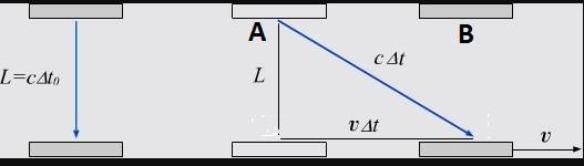

Time in reference frame with clock
I considered example of time dilation with light clock. I have a question about measuring time in reference frame with clock.
If we know that clock move from A to B in the reference frame with clock then what time of motion is measured in this reference frame? (In non-moving reference frame time is Δt)
I supposed that time is Δt0 because light reach at end point at this time. But I think it's wrong. I have no more guess.
Thanks.
It's obviously wrong from your diagram, because the distance covered by the light beam in the moving light clock is not ##c \Delta t_0##, it's ##c \Delta t##. Which should make the time it takes in the given frame for the light beam to cover that distance obvious.
Don't guess, compute!
Where is the light pulse when the clock is at A? Where is the light pulse when the clock is at B? How far has the light travelled, therefore? Hence, how long has it taken?

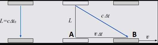

Sorry. Picture in the first message is wrong.
What has changed? The picture you just posted looks the same as the one in the OP.
I mean that vΔt is length of path in non-moving reference frame (time in this frame is Δt). And what is time in reference frame with clock?
Yes. So that's the time the light takes to travel from A to B in the non-moving frame, if the clock is moving in that frame.
Do you mean the frame in which the clock is at rest? Isn't that what you've drawn in the left part of your diagram?

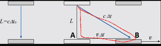

This conversation seems enormously confusing.
The diagram in #1 has two clocks, the one on the left which is stationary in the frame in which the diagram is drawn, and the one on the right which is moving to the right with velocity ##v##. In this frame, the period of the left clock is ##\Delta t_0## (well, twice that actually because the light pulse needs to travel down and up, but it doesn't matter here). The period of the clock on the right is ##\Delta t##, which turns out to be ##\left(1-v^2/c^2\right)^{-1/2}\Delta t_0##.
As far as I can work out, OP is asking what are the periods of the two clocks in a frame where the right clock is stationary and the left clock is moving to the left with speed ##v## (i.e. velocity ##-v##). If that is correct, then the answer is simply that the periods swap: now the right clock has period ##\Delta t_0## and the left clock has period ##\Delta t##.
Does that answer the question?
Ok. I'll try to rephrase.
Let's write equation for non-moving reference frame:
##(cΔt)^2 = (cΔt0)^2 + (vΔt)^2##
How to write equation for moving reference frame?
Do you mean the frame where the right hand clock is at rest? And how are you arriving at that equation? Are you just applying Pythagoras' Theorem to the triangle I've marked in red below?
Thanks to all! My mistake was that I tried to find time of motion in moving frame but distance in this frame is 0 because clock in moving frame is at rest.
