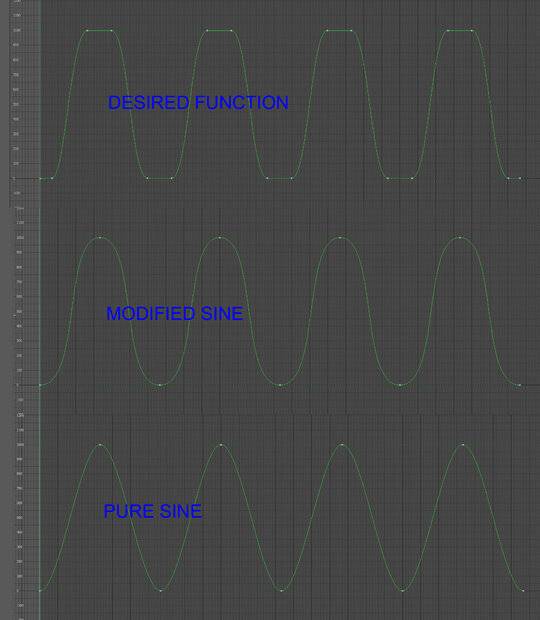

Many mechanical actions produce sine wave motion.
I require a mechanism that modifies the sine wave so it is flattened at its peaks.
Piston displacement as a function of time produces a sine wave.
I need to modify the motion so the the time the piston spends at both the bottom of the stroke and the top of the stroke are extended.
The motion curve would approximate a clipped audio wave.
The attached image shows three motions.
The "Desired function" maybe too harsh so I imagine a hybrid between this and the modified Sine may be better for smooth mechanical operation.
So I am searching for a mechanism (a mechanical arrangement) that can produce this.

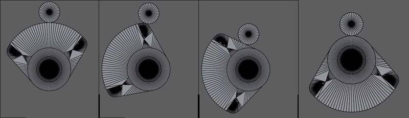

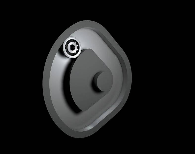

I have many of these but they are a compromise. To get the ideal function a cam would have large flat sections and at any speed faster than snail speed the cam follower would bounce. Rounding of the flat sections means less time is spent at peak displacements.
The two attached videos show the ideal cam and the possibility of encapsulating the follower.
But as I said another approach is preferred.
Hmmmm this forum does not support mp4 files so I have had to covert mp4 to GIF making the file much larger. NB From 159kb Mp4 to a 7mb gif which is too large the system tells me. Excellent.
So here I post 4 stills from the video

Here is the function: y = Sin( theta ) + Sin( 3 * theta ) / 10 ;
It has a maximally flat top and bottom.

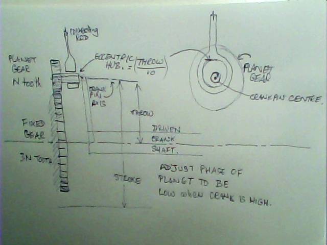

Please can you send a rough diagram showing me the arrangement of the gears I will then make a 3D model.

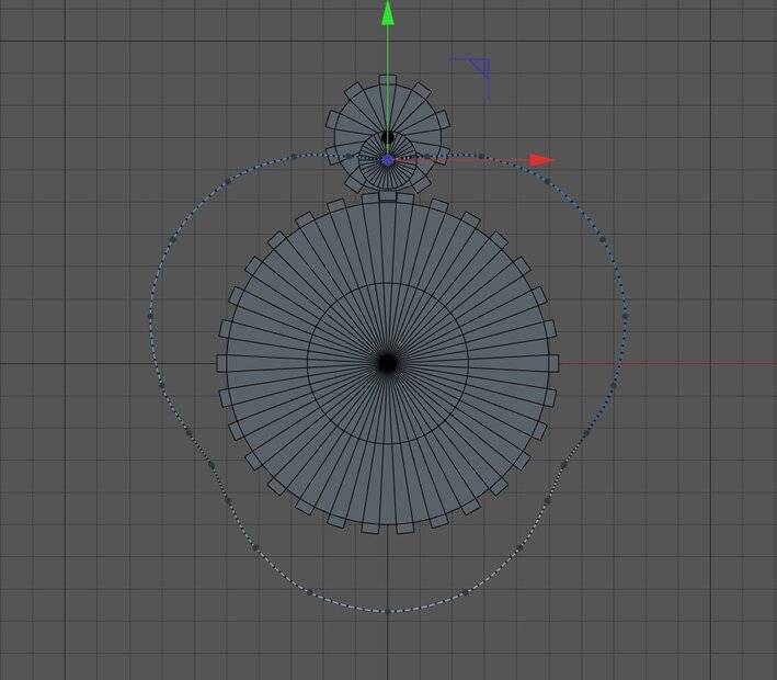

There are a great many mechanical implementations. It could be done by roller chains, or gears and cranks. Here is a first guess at a possible solution.
The crank turns and moves an N-tooth planet gear around a concentric fixed 3N-tooth gear wheel.
The centre of the N-tooth gear runs true on the crank pin, so the gear teeth always mesh, but the hub is made eccentric, with an offset equal to one tenth of the crank stroke.
The N-tooth gear hub generates the attenuated 3'rd harmonic, added to the crank fundamental.
The big end of a long connecting-rod runs on the eccentric hub of the N-tooth gear.
There will be a slight error due to a short diagonal crank on the rising and falling edges, but the top and bottom will be error free and maximally flat.
That mechanism generates; y = Sin( theta ) + Sin( 3 * theta ) / 10 .

Perfect flatness is probably not desirable as the mechanism needs to move smoothly, so approximate is probably better.
I will put together a static model and once you give my interpretation your approval I will animate it
Here we go...................
That looks good.
When it comes to gear tooth count, a minimum of 20 will give quiet running.
Being flat at the tip should not present an acceleration problem, since it must stop there, to reverse. The important thing is that it does not oscillate at the extremes, like a Chebyshev approximation does.

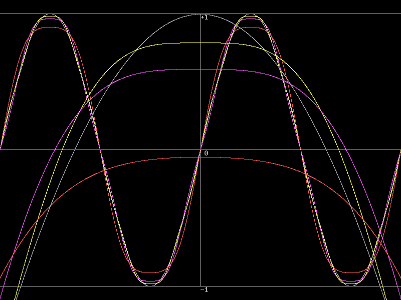

Because the flattening is symmetrical, the harmonics employed must be odd, like a square wave. Notice here, that the sign of the harmonic alternates, unlike in the Fourier transform of a square wave.
I looked at the fundamental plus one odd harmonic from the range 3, 5 or 7.
Notice the harmonic h, coefficient must be 1 / (1+h2) for maximal flatness.
They can all use the same mechanism, just with different gear tooth counts and hub eccentricity. The three flat-top equations I plot here are;
y = Sin( theta ) + Sin( 3 * theta ) / 10 ; red
y = Sin( theta ) - Sin( 5 * theta ) / 26 ; magenta
y = Sin( theta ) + Sin( 7 * theta ) / 50 ; yellow
With a sinewave in ; grey
Overlying those functions are zoomed in views of the flat tops.
You should select the harmonic that best suits your application.
The planet gear spins proportionally faster for the higher harmonics, but throws much less distance.
Likes Lnewqban and jack action

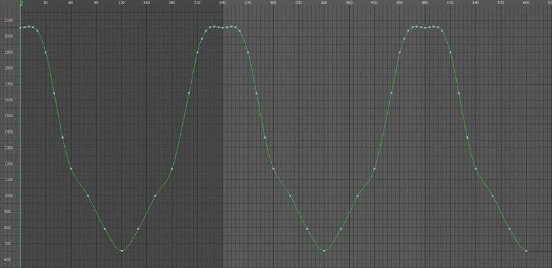

Forget about 3:1 it does not work.
https://vimeo.com/manage/videos/886060121
This is the piston motion
This is the path of the big end

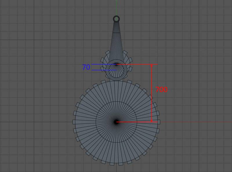

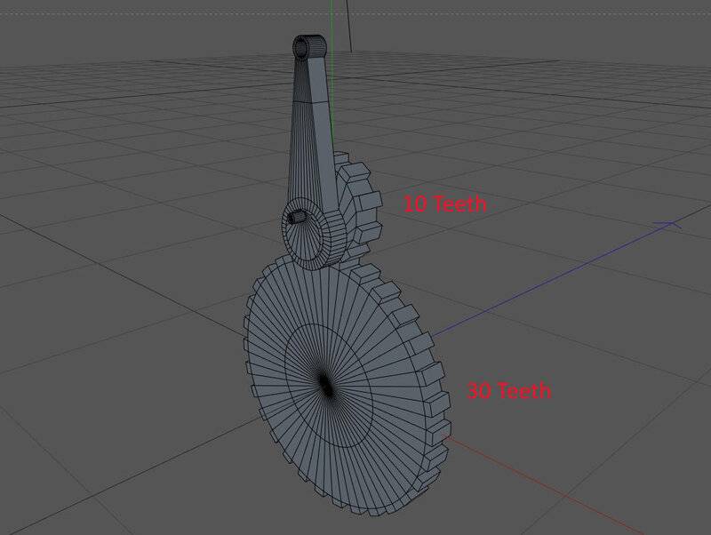

I tested 2:1 with 40 and 20 teeth gears
The small dip at the peaks can be removed by changing the position of the Big End relative to the the axis of the small gear.
I shall play some more.
This is my 3D model
The one I am building is very different
Apologies.
It is very easy with epicyclic planetary gears to forget to add or subtract 1 from the ratio. I knew it could be a problem, I just hoped I could get away with it for the first guess at a mechanism.
After rolling 180 degrees around the fixed gear, the planet should be upside down, but it appears to have been also turned over by the crank, since the top of the planet is then in contact with the bottom of the fixed gear.
Think really hard about it, or simply try a gear ratio of 2 or 4.
It is the gear carrier that causes the ratio ±1 problem, the piston movement profile should still be that plotted for the 3'rd harmonic.
