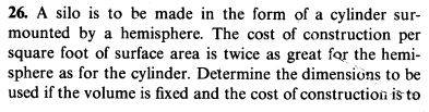

How to minimize the cost of a silo

First of all, you are not taking into account that the hemisphere costs more per surface area to construct than the cylinder. You are just computing the surface area.
Second, you have made an arithmetic error somewhere because your dimensions do not match.

A good approach but there are two things to note :
1. You're not trying to minimize the area, you're minimizing cost. In a way, you're minimizing some "effective area" function.
2. Have you ever encountered Lagrange multipliers?
Also, as others mentioned, check the algebra, but if you do get a convoluted polynomial for r, there's no shame in using a computer to find its roots.
I denote the cost as C:
$$\text{[1]}~ C=2\pi rh+4\pi r^2=2\pi r[h+2r],~~V=\pi r^2h+\frac{2}{3}\pi r^3~\rightarrow~h=\frac{2r}{3}-\frac{V}{\pi r^2}$$
$$\text{[2]}~C=2\pi r\left[ \frac{2r}{3}-\frac{V}{\pi r^2}+2r \right]=2\pi r\left[ \frac{8}{3}r-\frac{V}{\pi r^2} \right]$$
$$\text{[3]}~C'=2\pi \left[ \frac{8}{3}r-\frac{V}{\pi r^2}+r\left( \frac{8}{3}+\frac{2V}{\pi}r^{-3}\right)\right]$$
$$\text{[4]}~C'=0:~2\pi\left[ \frac{16}{3}r-\frac{V}{\pi r^2}+\frac{2V}{\pi r^3}\right]=0$$
$$\text{[5]}~2\pi\left[ \frac{16\pi r^4-3Vr+6V}{3\pi r^3} \right]=0$$
$$\text{[6]}~\Rightarrow~10\pi r^4=3V(r-2)$$

In the first line your expression for ##h## in terms of ##r## and ##V## is incorrect; ##V## should have a positive coefficient and ##r## a negative coefficient.
$$\text{[1]}~ C=2\pi rh+4\pi r^2=2\pi r[h+2r],~~V=\pi r^2h+\frac{2}{3}\pi r^3~\rightarrow~h=\frac{V}{\pi r^2}-2r$$
$$\text{[2]}~C=2\pi r\left[ \frac{V}{2\pi r^2}-2r+2r \right]=\frac{2V}{r}$$

$$C=2\pi rh+4\pi r^2=2\pi r[h+2r],~~V=\pi r^2h+\frac{2}{3}\pi r^3~\rightarrow~h=\frac{V}{\pi r^2}-\frac{2}{3}r$$
$$C=2\pi r\left[\frac{V}{\pi r^2}-\frac{2}{3}r+2r\right]=2\pi r\left[\frac{V}{\pi r^2}+\frac{4}{3}r\right]$$
$$C'=2\pi \left[\frac{V}{\pi r^2}+\frac{4}{3}r+r\left( (-2)\frac{V}{2\pi r^2}r^{-3}+\frac{4}{3} \right) \right]=2\pi\left[\frac{8}{3}r-\frac{V}{\pi r^2}\right]$$
$$C'=0~\rightarrow~r^3=\frac{3V}{8\pi}$$
The answer should be:
I have the number 8 in the denominator that's redundant

You are aware that the radius is half the diameter, right?
A bit of humor won't hurt...
About the h, i don't see it equals the diameter:
$$r=\frac{1}{2}\sqrt[3]{\frac{3V}{\pi}}$$
$$h=\frac{V}{\pi r^2}-\frac{2}{3}r=\frac{V}{\frac{\pi}{4}\sqrt[3]{\left( \frac{3V}{\pi} \right)^2}}-\frac{2}{3}\frac{1}{2}\sqrt[3]{\frac{3V}{\pi}}$$
This won't cancel to become 2r=h

After a few trials i got the right answer, that the height of the cylinder equals the diameter:
$$h=\frac{3V-\frac{\pi}{4}\sqrt[3]{\frac{3V}{\pi}}\sqrt[3]{\left( \frac{3V}{\pi} \right)^2}}{3\frac{\pi}{4}\sqrt[3]{\left( \frac{3V}{\pi} \right)^2}}=\frac{3V-\frac{\pi}{4}\frac{3V}{\pi}}{\frac{3\pi}{4}\sqrt[3]{\left( \frac{3V}{\pi} \right)^2}}$$
$$=\frac{\frac{9}{4}V}{\frac{3\pi\sqrt[3]{(3V)^2}}{4\sqrt[3]{\pi^2}}}=\frac{3V}{\sqrt[3]{\pi}\sqrt[3]{(3V)^2}}=\sqrt[3]{\frac{3V}{\pi}}=2r$$
