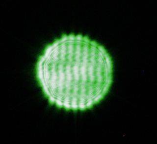

I'm strudying Fresnel diffraction, so:
Laser pointer -> ~-10mm diverging lens -> Slit -> 2m -> Camera
Is there any chance you could upload a picture of the diffraction pattern on the wall and give us an indication of its size?

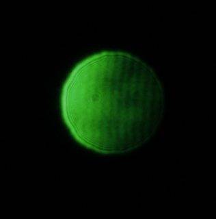

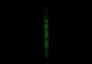

The image I see on the screen is something like this:
The central line about 1mm thick. The diffraction pattern covered the whole lens, so the size shouldn't be a problem.

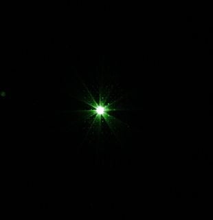

I used higher exposition times and open and closed diaphragms but got nothing. For example,
those points might be from the sensor, but it's not what I was looking for. It seems that the bright spot from the lase has some structure:
Would this be part of the diffraction pattern from the slit?
I was recommend to focus the camera at infinity, but since this is a divergent beam shouldn't I change the focus distance. Anyway, I don't think that's the problem because I tried several distances.

If you put your camera at the screen (no lens on the camera), the CCD should directly record the diffraction pattern.
Alternatively, try putting your camera (with lens attached, focused to infinity) as close to the aperture as you can.

The lens cannot project the diffraction pattern onto the camera sensor, because the pattern is not an aerial image. The lens will only project the appearance of the light source (pinpoint laser). You have two options:
1. Remove the lens from the camera and project the pattern directly onto the image sensor. Adjust the camera-to-slit distance to scale the size of the pattern to fit.
2. Project the pattern onto a diffusing white screen, then photograph it from there. Option 1 should give the better result.
You will still find variations in the light intensity due to phase variances in the laser source. This can be improved by adding a spatial filter directly in front of the laser, which is a short-focal-length lens such as a microscope objective, followed by a small pinhole. The distance from lens to pinhole needs to be set very accurately for good transmission efficiency.
