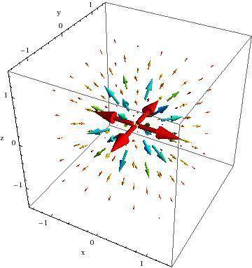

I want to graph this vector field -^r/r^2
but I don't know how to do.
Any help would be appreciated.

3D Spherical Case
In a similar way your initial problem is solved. For the conversion from spherical to cartesian see: http://en.wikipedia.org/wiki/Spherical_coordinate_system
The radial unit vector expressed by cartesian unit vectors is this time more complex:
[tex]\vec{e_r}=\vec{e_x} \sin(\theta) \cos(\varphi)+ \vec{e_y} \sin{\theta} \sin(\varphi) + \vec{e_z} \cos(\theta) [/tex]
Code:
r[x_, y_, z_] := Sqrt[x^2 + y^2 + z^2]
\[CurlyPhi][x_, y_] := ArcTan[x, y]
\[Theta][x_, y_, z_] := ArcCos[z/Sqrt[x^2 + y^2 + z^2]]
(* Unit vectors *)
ex[x_, y_, z_] := Sin[\[Theta][x, y, z]] Cos[\[CurlyPhi][x, y, z]]
ey[x_, y_, z_] := Sin[\[Theta][x, y, z]] Sin[\[CurlyPhi][x, y, z]]
ez[x_, y_, z_] := Cos[\[Theta][x, y, z]]
(* Components of the Vector Field *)
Vx[x_, y_, z_] := -(1/r[x, y, z]^2) ex[x, y, z]
Vy[x_, y_, z_] := -(1/r[x, y, z]^2) ey[x, y, z]
Vz[x_, y_, z_] := -(1/r[x, y, z]^2) ez[x, y, z]
VectorPlot3D[{Vx[x, y, z], Vy[x, y, z], Vz[x, y, z]}, {x, -1,
  1}, {y, -1, 1}, {z, -1, 1},
 VectorPoints -> 5,
 VectorStyle -> "Arrow3D", VectorColorFunction -> Hue,
 AxesLabel -> {"x", "y", "z"}]
For the result see attachment 2.
I would appreciate if someone would crosscheck my results. Since I am not that sure about my 3D case when i look onto the attached picture it seems for the line given by x=0,y=0,z there are no "red vectors" for example which point into the center.
@rbwang1225: Please tell me if that helped, and drop in your solution or mathematica code and or picture here when your finished please!

Which version of Mathematica do you use? I failed to use your code in M7 & M8. I don't know why since I think the code is right.
Regards
Sorry i broke the code by "cleaning it up", which means i did leave the z-dependence in some equations for [tex]\varphi[/tex] and in the end breaking the code :), here you go, should work with M7.

3D Spherical Case
Code:
(* Unit vectors *)
ex[x_, y_, z_] := Sin[\[Theta][x, y, z]] Cos[\[CurlyPhi][x, y]]
ey[x_, y_, z_] := Sin[\[Theta][x, y, z]] Sin[\[CurlyPhi][x, y]]
 VectorPoints -> 5,
If you discover why the red arrows arent plottet for (x=0,y=0,z) please let me know. (or if they work correctly in M8)
The following is what I got in M8
