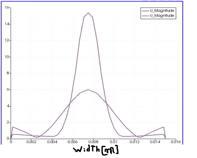

I am studying a flow going through an orifice.
I am aimed at overlapping the plots for the speed distribution over the vertical width profile (which is 0.015 m long; highlighted in red) for two downstream, horizontal distances [w.r.t. the orifice]: 0.01 m and 0.03 m.
The result should look as follows (the highest peak corresponds to 0.01m width profile)

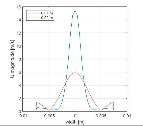

Let me share the code I got so far
Matlab:
clc
close all
clear all
warning('OFF', 'MATLAB:table:ModifiedAndSavedVarnames')
%step 0
Ai = readtable("sampleData10mm.csv");
Bi = readtable("sampleData30mm.csv");
A = Ai(2:1000,:);
B = Bi(2:1000,:);
%step 1
fCom_10mm = A{:,"U_0"};
sCom_10mm = A{:,"U_1"};
tCom_10mm = A{:,"U_2"};
width_10mm = A{:,"Points_2"};
U_10mm = sqrt(fCom_10mm.^2 + sCom_10mm.^2 + tCom_10mm.^2);
%refined_width_10mm = [0;A(:,"Points_2")+0.0075];
%refined_width_10mm = A{:,"Points_2"+0.0075};
%step 2
fCom_30mm = B{:,"U_0"};
sCom_30mm = B{:,"U_1"};
tCom_30mm = B{:,"U_2"};
width_30mm = B{:,"Points_2"};
U_30mm = sqrt(fCom_30mm.^2 + sCom_30mm.^2 + tCom_30mm.^2);
%refined_width_30mm = [0;B(:,"Points_2")+0.0075];
%refined_width_30mm = B{:,"Points_2" + 0.0075};
%step 3
figure
plot(width_10mm,U_10mm,width_30mm,U_30mm)
%plot(refined_width_10mm,U_10mm,refined_width_30mm,U_30mm)
legend({'0.01 m', '0.03 m'},'Location','northwest')
xlabel('width [m]')
ylabel('U magnitude [m/s]')
axis square;
grid on;
Which yields
I am almost there. I am working on how to get the zero at the x-axis y-axis intersection:
