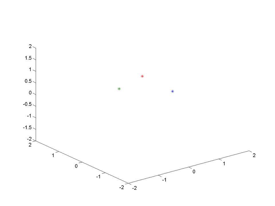

This might be an unusual thread but is that i really can't figure out how to plot single points in 3D space using MatLab.
I need to plot the points (1,0,0) , (0,1,0) and (0,0,1)
Do you mean something like that?
You can do it,by using the following commands:
>> plot3(1,0,0, '*',0,1,0,'*', 0,0,1,'*')
>> zlim([-2 2])
>> ylim([-2 2])
>> xlim([-2 2])
