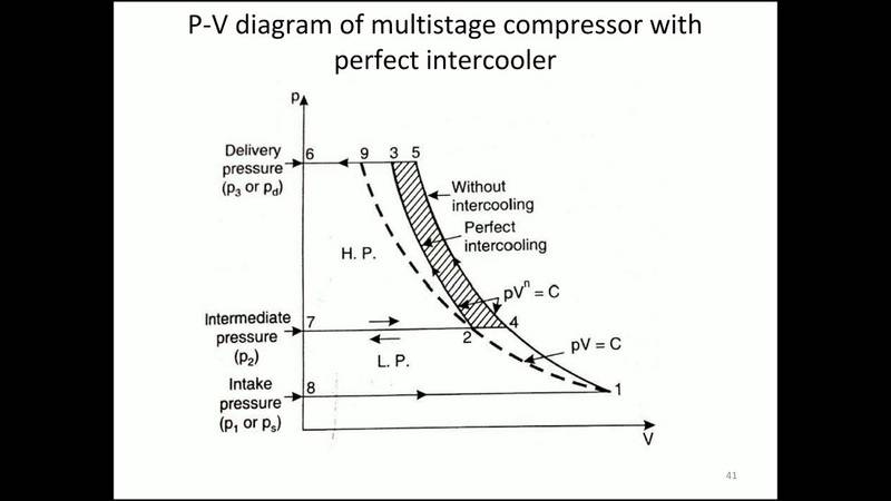

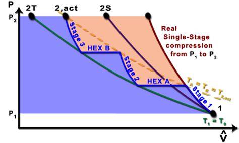

An isothermal compression will always be more desirable than an isentropic one. This is why we prefer compression in multiple stages with intercoolers. Having perfect isothermal compression at high speed is very difficult. But isothermal is not adiabatic.
In the following image, the "real single-stage compression" is what I was referring to when talking about a compression process with a polytropic index different from the heat capacities ratio.

What I mean is that if our goal for a compressor is to have compressed air at it's highest pressure and lowest temperature, meaning a higher density, for a given cycle rate (rpm), a reversible adiabatic process is more efficient in converting the work to compressed air. Say you have reed valves that only open at the target pressure. If the process was irreversible, the temperature would be higher for the same delivery pressure and the density lower as more work was converted to heat. This lowers the mass flow rate for the same cycle rate (rpm). The goal is to "compress" air, not just pressurize it. You could pressurize air by simply heating it which is not what we want. We want to compress air with minimal amount of temperature increase which happens with a reversible adiabatic process.
In the isothermal case, you may have a compressor that is more effective for it's size, and maybe that is what you intended to point out, but the intercooler is wasting energy so I don't see how it could be more efficient.
Would you disagree with any of my statements here? Let me know if I'm mistaken.

I disagree with that.
The work done is the area under the curve on the P-V diagram, which is clearly smaller for the isothermal case, considering the same volume ratio:

Just two practical considerations:
Adiabatic and reversible compression will not deliver the performance that is needed from a real air compressor.
Trying to save in weight, as well as in machining and material costs, the manufacturer will try to use as little metal and as high rpm's as possible.
That works against internal volume, heat exchanging surfaces, lubrication and slow internal air flows.
MysticDream said:
I don’t understand why cooling is more efficient. You’re not reusing the heat to compress more gas. You’re throwing it away.
Yes, the user will be throwing away energy in the form of wasted heat for the whole life of the air compressor.
The main causes are that the safe temperatures at which metals and lubrication can work is relatively low, compared to what the compressed air could reach with enough motor power (shaft torque and rpm's).
Based on the manufacturing versus costs compromises slightly explained above, the manufacturers will not tend to be generous in heat exchanging surfaces, less crazy flow velocities, lower rpm's, more complex valves, or about any other investments.
Simply, their main interest in in sales and profit, rather than in means to conservate energy in industrially and commercially compressing air.
Adiabatic and reversible compression will not deliver the performance that is needed from a real air compressor...
Yes, good points and understood. The size and cost have to be practical. I'm asking these questions to have a better theoretical understanding of the process. I appreciate your input.
Likes Lnewqban
  • #31
That is excellent!
I recommend that you study centrifugal compressors, as their internal compression process is much less brutal than the one happening in reciprocating machines.
Please, see:
https://lindbergprocess.com/2020/01/centrifugal-vs-reciprocating/
