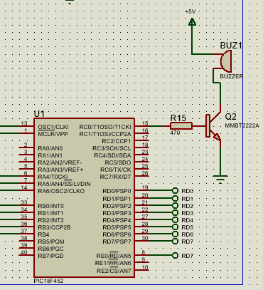

TL;DR Summary
I have connected the Buzzer to the RC0 pin of PORTC but it is not working, I need it to sound with a period of 5 seconds on and 5 off. I can definitely handle the periods with timers or delay functions but I need the circuit to be working first.
crystal frequency is 4MHz
The code i have tried is:

What kind of a buzzer? Some will work just after applying voltage, some are just "speakers" that need an external oscillator/generator.
Check if a loop with 1ms delay between on/off states will produce any sound, you should get around 500Hz. Some buzzers are designed with a specific frequency in mind (like 2700 Hz) so it can be quiet, but at least you will know if it works.

Nevermind haha I have managed to make it through with some work, i had to also switch to a DC operated buzzer
Here is the code I have used:

A problem I am facing at the moment is why doesn't the __delay_ms(5000) work after the buzzer = 1 line?? For example, if I make the while loop such that I want the buzzer to turn on and off at 5 second periods each:

Has it got to do with the while loop by any chance?

This is an electrical engineering forum. If the buzzer BUZ1 now includes a magnet coil, then you will need to add a parallel flyback diode, to protect the BJT Q1 from the flyback voltage spike.
