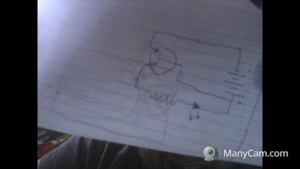

if i use this circuit the diode won't light up.

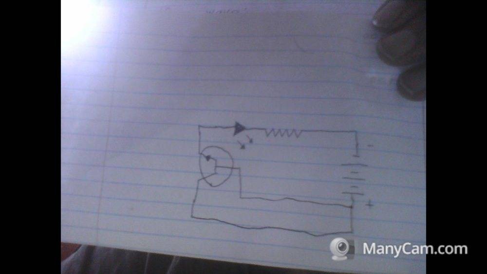

if i use this circuit the diode will light up.
is this normal? i don't know if this is normal.
i am using a led as a load and the battery voltage is 3.7 to 4.1 volts.
if i use this circuit the diode will light up.is this normal? i don't know if this is normal.
Very normal. In your first circuit you are trying to flow current backwards through the LED. No current flows, so it doesn't light up.

in my first circuit i connected the positive lead to the positive terminal and connected the negative terminal to
the transistor's collector. is this still normal?
No. As @phyzguy said:
so my first circuit cannot work?
That is correct. Just look at the arrows. In the top circuit, the current through the transistor is flowing from bottom to top, in the direction of the arrow on the emitter. So it will attempt to drive current from right to left through the LED, which it can't do.

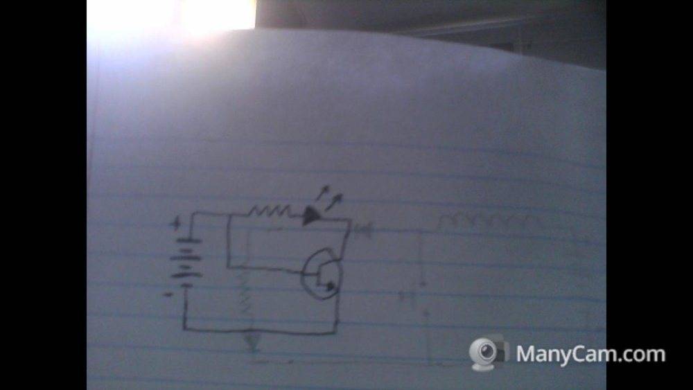

when i try the first circuit, the anode of the led is connected to positive terminal and the cathode of led is connected to the transistor's collector. the led still won't light up. the led cannot light up?
Show us a diagram of your new configuration.
this is the configuration i am using.
the led won't light up if i use this configuration.

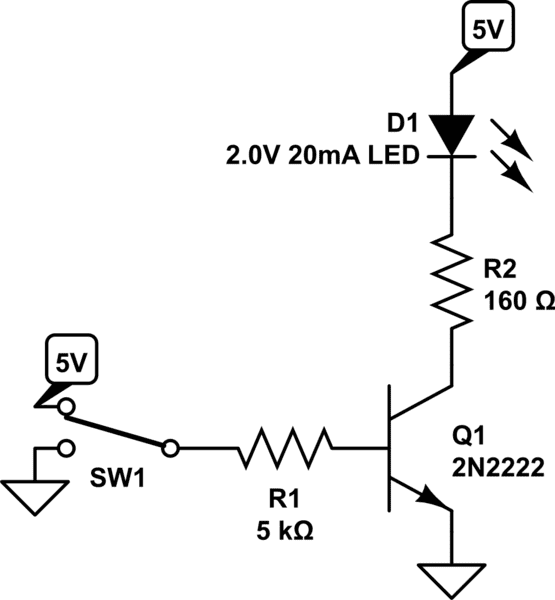

I would expect it to light up in this configuration. You may have fried the BJT. You really should have a resistor in place to limit the base current, like @berkeman showed in post #10. You could try measuring the current flowing in each leg of the circuit.
agreed, but without that base resistor as @phyzguy said, the transistor may have been damaged
due to the excessive current flow through the base to emitter
What is the transistor "model/type" ?
Even if it is not damaged, the base-emitter junction would clamp the battery voltage below the voltage required to turn on the LED. It needs a base resistor as shown/discussed above.
