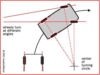

I am aware that the front wheels angle are different from each other when rotating, assuming slip angle are zero, with rigid tires.
is it okay for me to think of the car turning design like this:
the driving force of turning is the difference in speed of the back wheels, one is greater than the other, and since the distance between the two back tires don't change, therefore the only possible motion for the back wheels is rotation + translation.
and the plane of the front wheels are just oriented normal to the point of rotation to "fit" the current rotating motion about rotation point O. in order to minimize resistance.

If you extend the axis of the front and rear tires of a car with imaginary lines, the point at where these lines cross is the radius the car will tend to turn. The actual radius will be somewhat larger due to 'slip angle' (the deformation and some slippage at the contact patch) depending on the load on the tires and how stiff the tires are.

0:07-0:10
At very very low speeds, the car turns in the direction that the wheels are pointed. So your turn centre is in line with the rear wheels. Ie, draw a line perpendicular through the rear wheels and perpendicular to the front wheels.
Unless you have a geometry that allows the inner and outer wheels to take different paths (because the inner wheel is taking a shorter radius) you will scrub the tyres.
Reference: Ackermann steering angle
At higher speeds the tyre tread distorts meaning the tyre is traveling in a different direction than the contract patch. The angle between these two is the slip angle. This slip angle induces a cornering force which acts to turn the car into the turn.
This is the crucial thing. The lateral force caused by the turn induces a slip angle in the rear wheels. So the rear wheels are actually contributing to the turn. The centre of the turn (instantaneous centre) is now perpendicular to the slip angles front and rear.
When the front slip angle exeeds the rear, the car will understeer.
When the rear slip angle exeeds the front, the car will oversteer.
In your scenario, the car will permanently and terminally understeer as you have no slip angle on the rear.
I've bolded several words/concepts above. You should try to read up on them before approaching this again. If you have any questions on them, just ask.

Because of deformation, and some slippage at the contact patch, the actual radius will be somewhat larger than idealized radius. In race cars, because the downforce on the tires is greater on the outside tires, ackermann is reduced or eliminated and toe in may be used, so that the inside front tire has less slip angle than the outside front tire.
Even in the idealized case of no tire slipping and perfect ackermann steering, you still have some of the turning force provided by the rear tires, due to the centripetal acceleration of the car resulting in a reactive outwards force on all 4 tires, with an equal but opposing inwards (centripetal) force from the tires (a Newton third law pair of forces, you also have outwards force of tires on pavement, and equal and opposing inwards force of pavement on tires). The ratio of force between front and rear depend on weight distribution of the car (assuming constant speed). Image of an idealized example of a car turning, no tire slipping, and perfect ackerman steering setup:
I have another drawing that shows how all four wheels can be tangents to the curve they are following if the front two wheels are at different angles...
I imagine that the steering linkage can be made to do almost anything you want. It must be a matter of what makes vehicles corner best at speed.
PS No one has yet mentioned the technique of additional rear (four) wheel steering which has been used for high end cars.

I just looked in an old book of mine on sports cars by Colin Chapman - designer of early Lotus cars. It reminded me of the term 'Ackerman Steering' Google this term and you will find loads of stuff to help you.
And are these "inward" forces reaction forces normal to the planes of the front wheels caused by the "forward" forces on front wheels by the back wheels?
