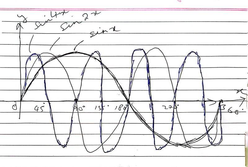

We need to prove that ##x = sin{\omega t} + sin{2\omega t} + sin{4\omega t}## where ##x## is the displacement from the equilibrium position at time ##t##.
I can see that each term is a SHM, but not sure if the sum of these terms would be a simple harmonic motion.
Also, I can see that the time period of third term is one-fourth that of first term and time period of second term is half that of first term.

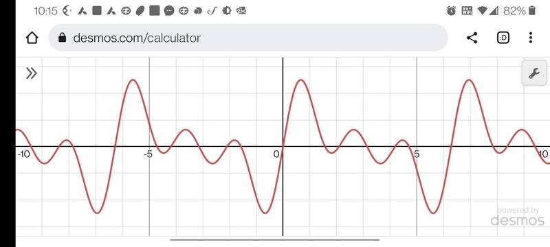

It is interesting that the easiest way to do this problem is to graph it for interval τ such that ωτ~10 π. You will immediately see if it repeats and if it looks like a sinusoid. Then you can show the result analytically as required. A lesson well learned

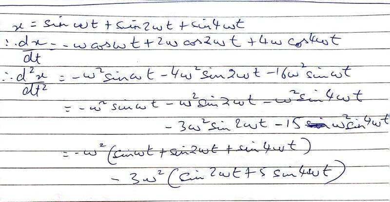

I get the following, after taking, second derivative of ##x## wrt ##t##.
##a= -\omega ^2 x -\omega ^2 (3 sin{(2\omega t)} + 15sin {(4\omega t)})##
Since for SHM, ##a= -\omega ^2 x##, so it's not SHM after looking at the above equation for ##a##. Is that correct reasoning?

Yes, my mistake. I had the following in my notebook, but wrote it incorrectly in the forums.
##a= -\omega ^2 x -\omega ^2 (3 sin{2\omega t} + 15sin {4\omega t})##

So it seems. But are the two the same kind of zero in the sense that ##\sin(\omega t)## crosses the axis going the same way? That's why I suggested that you plot this thing.
Likes erobz and vcsharp2003

First thing I did. :wink: We often take for granted the tools we now have at our disposal to answer these types of questions with almost no effort. Then (once you know what you are working toward) worry about the mathematical purist approach!

Just plot it first like @kuruman suggested.
