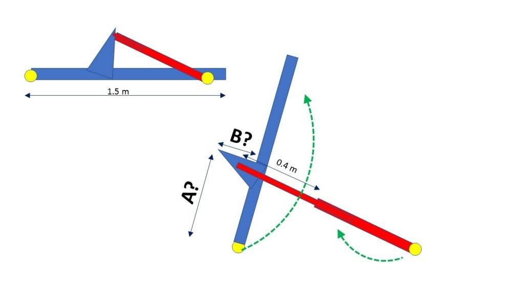

In summary, the electric actuator can push 130Kg and can extend 0.4m. The panel length is 1.5m and the weight is 50Kg. The maximum tilt angle required is +/- 80 degrees and the minimum actuator length is 0.4m.

Ideally I want the panels to go to/from totally horizontal to nearly vertical so from flat to plus +80 degrees, tx for your assistance my trig is really failing me on this one...:)

I am actually building a 2 Axis rig, I only asked about the elevation equation as I have the East/West axis sorted already. I'm going to be pretty much permanently on the move as my visa only allows me in the US 6 out of 12 months so I do spring up the west coast 3 months in Canada, 3 months down the East coast and winter in Mexico, then rinse, dry, repeat So I have set up the control program to activate the panels when the slide outs from my RV are activated and close when the RV gets closed down.
To answer your question re energy efficiency on 1 V's 2 axis systems - The North/South or vertical axis will improve upon a static panel by about 30-35%, the horizontal or East/West axis only gives an extra 5-10%. As I'm on the move all the time and often in desert terrain I need to bleed as much as I can out of the panels hence dual axis but if I was in one place and didn't need every volt possible I'd probably go single axis. I also have a generator which pumps out 10Kw @ 50a which is the same as having a direct shoreline hookup but it eats fuel which is why I want the solar rig to be as efficient as possible.
The reason I am asking about the most effective pivot point (the A & B question) is that I want to make the rig as compact as possible and possibly market it at some stage.
What is the total length of your actuator at full extension?

Full extension end to end is 1m give or take a few mil

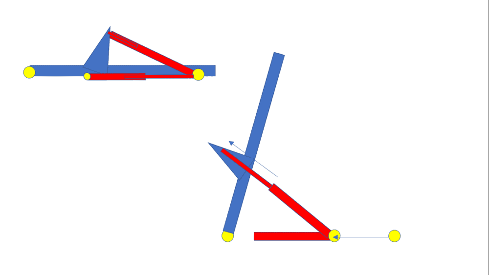

I plan to have a wide sturdy base to attach to the roof to which I will mount a lazy suzan swivel (500lb capacity) to which I will mount the 'easel'set up you describe. I'll have an actuator that turns the entire 'easel' for east/west tracking and then the vertical tracking it the bit I need help with as described above.

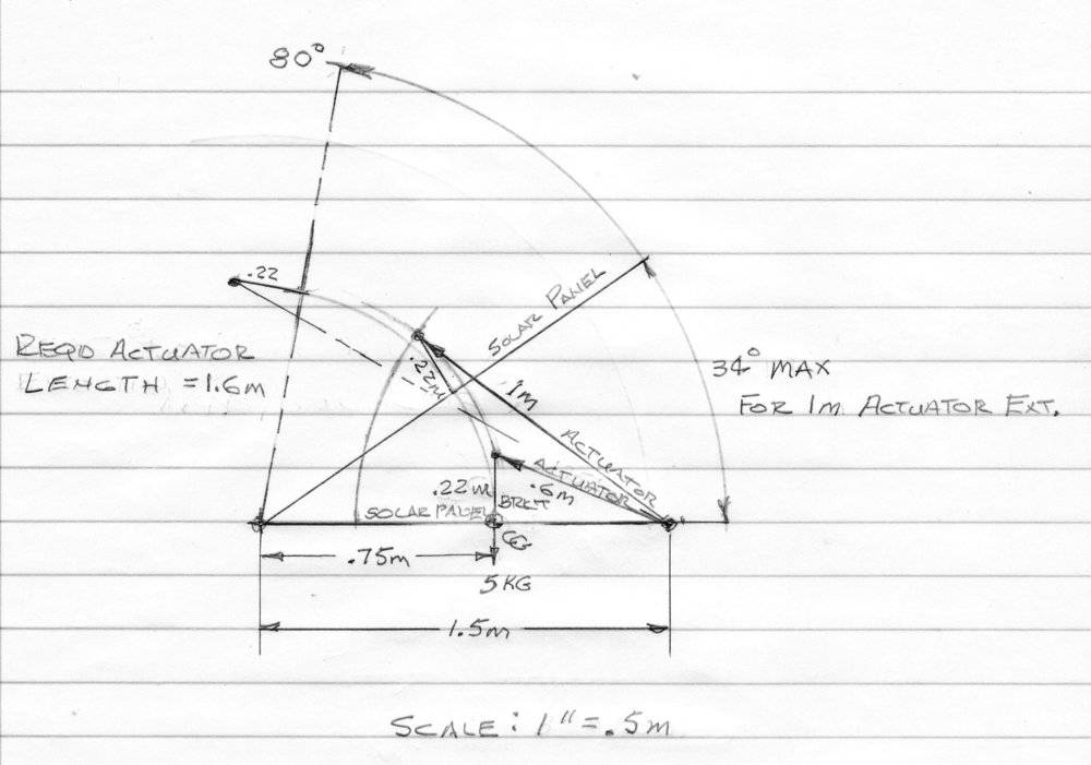

I did a preliminary analysis of your arrangement and then decided I needed to do the below scaled sketch of a typical result to verify what I had calculated. Unfortunately, both show that it is not be able to accomplish what you want with the current 135 kgf and 1 m extension actuator.
What controls the entire arrangement is the ratio of the 135 kgf vs the 5 kg weight vs the length of the lever required to provide the necessary leverage for the actuator to initially lift the solar panel from it horizontal position. You can see that I used a lever connection point at the CG point of the panel in my example and the limited panel lift angle that is achieved by that location.
The issue is the leverage ratio set by the lever location relative to the panel's CG at .75 m from the pivot. As a result, moving the lever and actuator closer to the solar panel pivot in an effort to get more lift angle is self defeating. For example, if the lever is moved to .375 m from the pivot then the effective panel load for the actuator is 5 kg x .75 m / .375 m = 10 kg and the height of the lever must be correspondingly doubled for the 135 kgf actuator to initially lift the horizontal panel.
At any rate, the diagram shows you how to go about using a diagram to evaluate the alternatives for yourself. Since I retired I no longer have access to CAD, so I had to revert to my prior 20 years of manual drafting with a scale, protractor and compass for the sketch and a lined 8 1/2 x 11 lined pad was the item closest at hand.
Likes berkeman and anorlunda
Thanks so much for putting the time in JBA. If I have understood you correctly, my original set up would work from a lift/power perspective but would only elevate the panels to 34 degrees. I have a second identical actuator which I was planning to use for the east west axis but I can use motors for that. I' thinking of keeping the original set up with a twist, use the second actuator to 'pull' the pivot point of the first actuator closer to the pivot point of the solar panels so as actuator 1 extends, actuator 2 retracts (bit like an old school deck chair) - thoughts?
Thanks again JBA. I have found a 2d modeler called Linkage which should help (still working out how to use it). I'm just working out placement of actuator pivots for max speed/efficiency so one pushes and one pulls at the same time. Tx again.

For reference: I used my diagram and started at the bracket to actuator connection position with the panel at the 80° elevation angle as the starting point. I then drew a circle of 1 m radius to find the original actuator's extended length intersection with the horizontal base; and, this indicates the horizontal actuator will need to withdraw .75 m from the original actuator pivot starting point to the point required for 1 m actuator to finally lift the panel to its 80° elevation angle.
For safety, I also did some basic actuator force calculations in order to confirm my expected low values and those indicated that at the full lift position the forces from the effective panel weight on both actuators should be less than 1 kg.
Also, a similar calculation indicates the tensile force on the horizontal actuator at the start of the lift will be 125 kgf.
I am sure you realize that all of these values are approximate due to being based on ideal conditions and component locations.
In that respect, one particular note of caution: I took credit for the full 135 kgf ability of the lifting actuator in determining the .22 m height of the actuator bracket above the panel; but, that is not practical for your acual application because it allows no safety factor to address pivot friction loads, etc. You can reduce that 135 kgf required load to correct that issue by extending the height of the actuator to bracket pivot beyond my current .22 m.; however, this will correspondingly result in an additional bit of required travel for the horizontal actuator.
At this point, I will leave the rest to you; but am available to try answer any upcoming questions.

At optimal angle to horizontal, for your latitude and time of year, there is a single angle if you do not have the lazy susan. The sun should move through a plane at perpendicular to the plane of the panel. The sun should pass through a point normal to the panel at high noon. With the panel oriented south, any tracking will only turn the panel further from the sun. There is no tracking that can improve this unless you add the lazy susan as well.. then you keep the sun normal to the panel all day, and you get a big increase in efficiency.

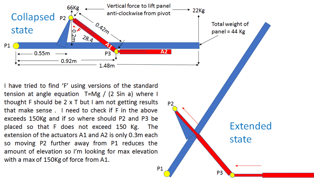

Here's where I got to, can anyone help with the equation I need?
First, simplify your diagram by using a simple perpendicular line to connect P2 to the face of the solar panel because that is a critical dimension in this analysis.
(Once you determine the critical dimensions for the design then you can start working on the actual bracket design).
The maximum compression load on A1 and A2 occurs at the start of the solar panel lift from its horizontal position. As a result the ratio of the from the panel CG to the perpendicular bracket base location and the bracket height are what determine the amount of compression loadings on A1 and A2.
For your current configuration, the vertical force to lift the panel from flat = 44 Kg x (1.48 / 2) / .55 = 59.2 Kg; and, (assuming the .2 m dimension is vertical height of P2 from P3) then the resulting compression load on A1 = 59.2 x .42 /.2 = 124.3 Kg; which means you can shorten the the bracket to .2 x (124.3/150) = .165 m
With that required bracket length determined, you then have to determine the combined extended lengths for A1 and A2 required to raise the solar panel to your target elevation angle.
That's brilliant JBA, thank you. I think I'll leave the measurements as they are as the motors should last longer and will also be able to lift on occasions when water/snow/wind may effect the lift weight. You are a star my friend.
