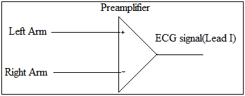

ok, let me explain:
ECG signal is obtained by using preamplifier as figure below:

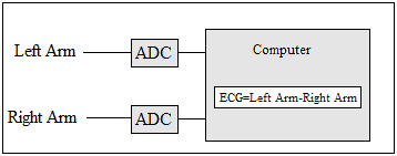

i want to record ECG signal but without using preamplifier, first i will record the two signals come from right and left arms, then inside the computer(by using matlab) i will obtain the ECG signal mathematically "ECG=Left arm-right arm", as figure below:
so i need ADC of a high resolution because the ECG signal is very weak (about 1 mV),
also i need to record the two signals (come from right and left arms ) at the same time to make the subtraction operation inside the Matlab.
i can't use amplifier before the ADC because the noise is very large (about 0.6 to 1 V P.P)

Can you use a very narrow band-pass filter to reject most of this noise (kind of like a preselector in an RF front-end?). Then, after you've knocked the noise down, you CAN use a preamp and make your life MUCH easier.
I'll just accept the fact that you want to record raw data (for now). A/D converters require anti-alias filters. Do you understand the aliasing issues. Frequencies higher than 1/2 your sample rate fold back into your signal bandwidth. You need to remove the out-of-band noise.
regarding a 20 bit converter:
Assuming 1V p-p 20 bits is 1uV. Since your signal is 1mV you can use fewer bits. Especially if you process it to remove the noise. In theory you can recover signals that are less than the step size of the converter if the input has adequate noise (dither). I'm guessing 20 bits is way overkill. 16 bits would give you 15uV steps.
If, in the process of anti-alias filtering, you reduce the noise and add gain, you will be able to use much fewer bits.

i know that i am using the hard way, i do that because my supervisor want me to do that.

the main ECG signal is about 1 mV, but the ECG signal has important features(components) of about 0.05 to 0.1 mV
so , can i record this signal by using 16 bits ADC, and then recover it efficiently ?
One reason you are swamped by noise is that you have no ground reference. You need a ground reference electrode and a high-impedance instrumentation amplifier. More sophisticated systems that drive the body reference electrode are also available, but start simple. Suggest you read one of the many good books on biomedical instrumentation to understand how to do it before building anything.
Since you are dealing with human subjects, safety is a paramount issue. It is standard practice in medical electronics to absolutely isolate the circuits that contact a person from any and all equipment that connects to the power mains. You can do this by running your front end preamps/filters/samplers from batteries and transmitting the digital signals to your computer via opto-isolators. There are also high isolation power supplies available that are human-safety-rated. This must be taken seriously. Again there is much information available on how to do it.

@samaa -- marcusl's post is excellent. I suggest that you and your supervisor talk it over in detail. If your supervisor does not understand anything that marcusl has said, that is very worrisome...
I concur with the safety points that have been raised. That is actually the major design issue. The amplifiers, digitizers and post processing issues are actually pretty simple. The safety issues are difficult, and very important.
