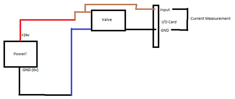

The sensor output looks like this:
The power supply is 24v, I don't know the current or the internal resistance of the supply.
As you can see from the picture, the +24v is going to the input of the card and the output of the sensor (4: Black) is going to the ground of the card.

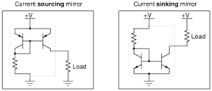

Use two current mirrors? (two transistors each)
Ah okay, I haven't done much work with transistors. I've just looked it up and it seems like it could work.
Would I be able to reverse the current with a current mirror? I assume I would just take the output of the current mirror and switch the wires the other way round. But I'll investigate. (Or wait until someone tells me that's completely wrong!)
With the example circuit below, you drive your reference current into the left transistor, and the right transistor sinks the same amount of current...

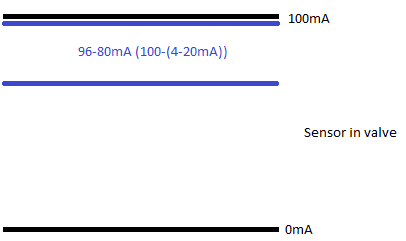

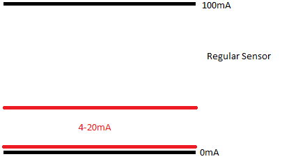

Now, the one's they usually use seem to do this (example, 100mA supply 24v DC):
But the ones in the valves seem to use the supply current as the reference, rather than ground.

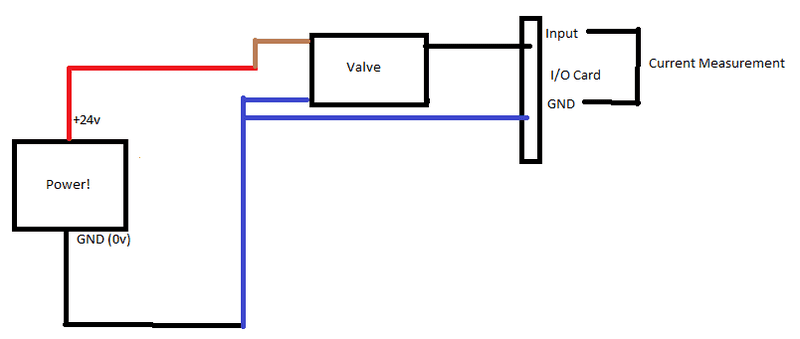

Prepare yourselves, this might be painful:
So this is how it's working so far.
And the measurements are 4-20mA, but the valve is changing that black output wire. There are 4 inputs on that card, 3 of them can't be used because the common ground input to the card is being changed by the valve.
This is how I'd like it to work, but it doesn't work this way.
Bear in mind that the black wire from the valve is the signal wire, not ground (I don't know why they chose black).

If you take a look at this
http://www.smcworld.com/upfiles/manual/e/E-ITV-STD-RF-A.pdf
On page 6, you'll find a diagram, top right. The positive of the "monitor output current" is attached to the positive of the power supply, that's where I put my red multimeter stick. The negative of the "monitor output current" is the black wire from the valve. This is where I put my black multimeter stick. The valve is disconnected from the I/O card at this point, else I'd be trying to measure current in parallel!

Another solution is to use a current mirror to convert the sink output sensor into a current source.

Your current mirror would work, but not in the configuration you drew (just need to turn it over). Sinking 4-20ma on one leg needs to be translated into sourcing 4-20ma on the other. Like the left hand side of this image
