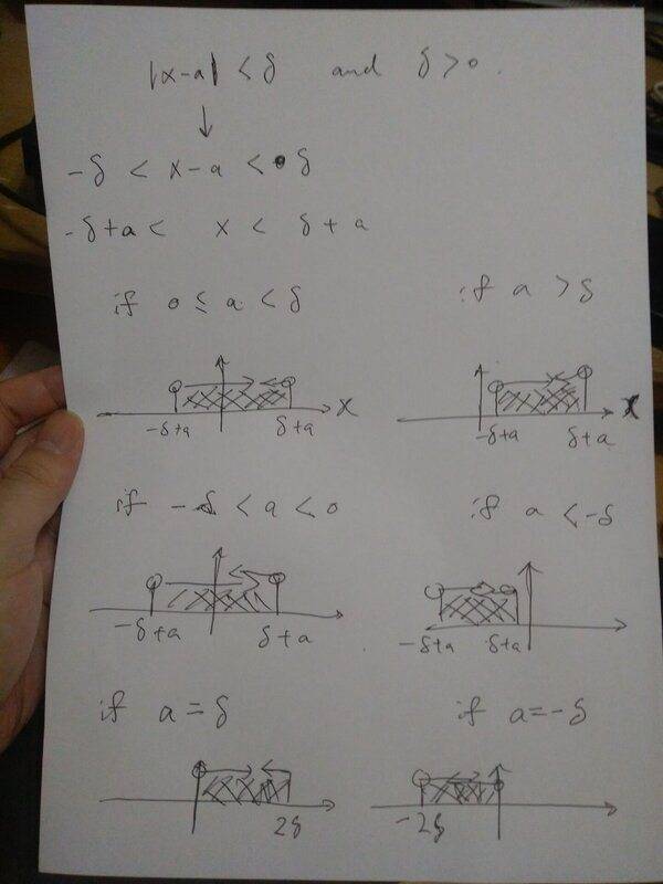

see attached image, it asks to repesent it in x-graph
constant "a" isn't conditioned.
Do I need to separate it into a few cases of the constant a and represent each in one x-graph?

OK . This is what I have done, I don't know if I am correct. I am teaching my cousin, but I have left school for 20 years

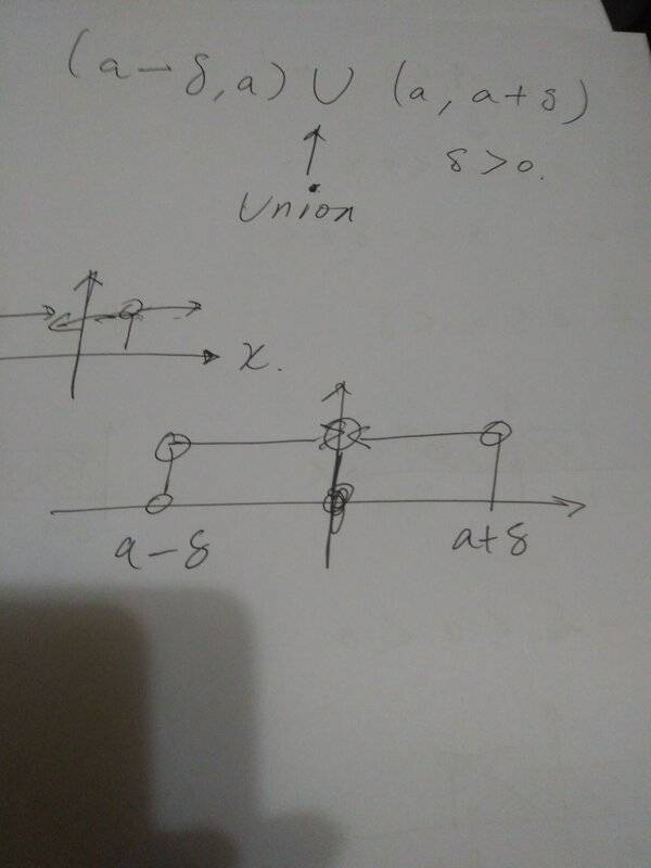

Another question , I avoid starting a new topic. Am I correct??
I think all you need to do is show one interval ##(a - \delta, a + \delta)##. You don't need all those different cases. The point ##x = 0## is not important here.
I guess that's ##0 < |x - a| < \delta##?
To make your diagram more clear, show ##a## on it. Then show ##a-\delta## and ##a+\delta##. There is no reason to even show where anything else, like ##x=0##, is. Then one diagram takes care of all the cases.
Hi, did you mean I do not have to consider the possible ranges of value of a ? (Since a isn't conditioned but the delta is given that >0, that's why I am wondering if I need to separate a into different ranges of value
No, "Another question" is really another, not related to the first question, yes the first question was ##0 < |x - a| < \delta##
I think the second question does NOT include x=0. How to draw a symbol to represent that x=0 isn't included?? an arrow??
You don't have to consider different values for ##a##.
It's ##x =a## that is excluded. I would just use ##(a-\delta, a)(a, a + \delta)## with round brackets to show the end points are excluded.
