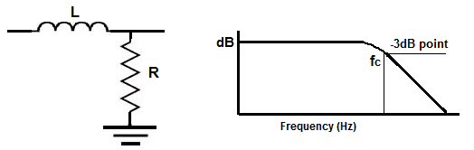

The ferrite/inductor works with the input impedance of the amplifier to form a low pass filter (eg that allows audio and blocks RF frequencies).
Scroll down this page to "RL low pass filter" for the maths.
http://www.learningaboutelectronics.com/Articles/Low-pass-filter-calculator.php
The value of the inductor might not be super critical as there is likely to be a reasonable difference between the frequencies you want to pass and those you want to block.

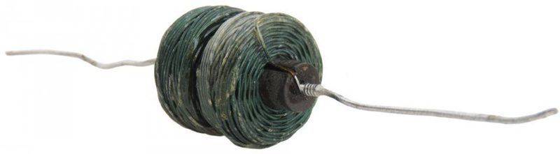

Valve circuits once used series resistors having a low terminal capacitance, with the choke coil(s), lattice-pi-wound on them in electrical parallel with the resistance. They were dipped in paraffin wax to hold the winding in place and to keep out moisture. Those early RFCs dropped little voltage for the DC bias and audio, but presented the resistance to RF signals.
Using a modern low-loss ferrite core alone on a valve electrode connection can make a resonant circuit with electrode capacitance at some frequency. Without resistance, an RF choke makes an energy reflector that keeps the RF energy bouncing around in the circuit. There needs to be somewhere for the unwanted RF energy to go, to be converted to heat and so reduce the gain below unity and kill any possibility of ultrasonic or RF oscillation.
