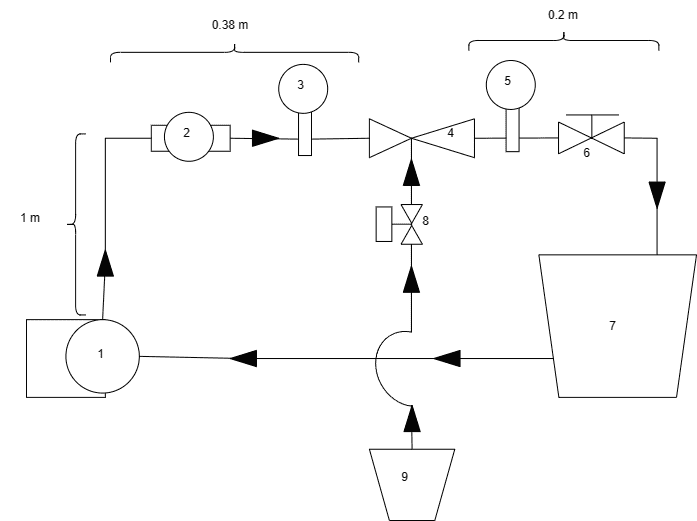

I'm building a fertigation system using 1 inch venturi injector with ball valve at the end to simulate drip irrigation system pressure requirement. i have read to start an injection you need 30% pressure difference between injector inlet and outlet. the pressure I'm simulating is around 10 meter head meaning it need 13 meter head at the injector inlet. currently I'm producing less than 4 meter head at the inlet. I'm still confused how does venturi injector work especially at predicting operating pressure at the inlet given certain pump curve. Is it the pump that is inadequate or should i just change to a smaller injector? this is the setup i'm currently using:

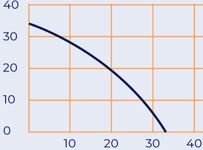

This is the curve of the pump I'm using, its a 125 watt output pump

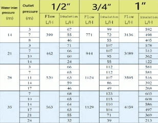

this is the performance spec of the injector:

i have installed pressure gauge next to the pump and it reads 0.5 bar or around 5 meter head. according to pump curve the pump should give a flow rate of 30.5 L/min. I have calculated the loss from the 1.4 meter 1 inch pipe and it gives around 0.07 meter head loss (absolute roughness 0.0015). So why would the pump operate at 5 meter head if the loss from the pipe only 0.07 meter? i'm guessing it's because the contraction at the venturi but when i calculate the loss coefficient (Kl) it gives a 0.72 value (from cengels fluid dynamics book gradual contraction with an angle of 60 degrees have Kl of 0.07). So where do i miss?

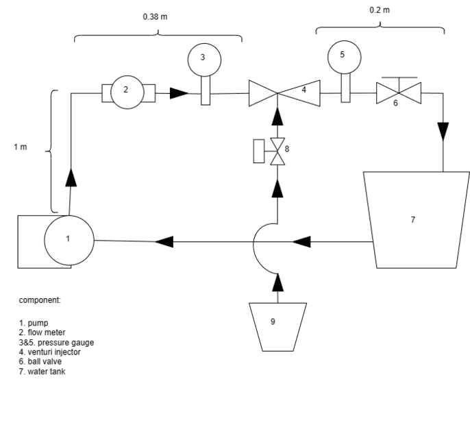

What is the pressure difference across the pump(Discharge - Inlet)? Also, is it correct to say you are basically pumping water - or is it more viscous due to the additive?
What are the units on your pump curve? Provide a link to the pump manufacturer's performance documentation if you can.
The other obvious question is "2" is a flow meter, what does it say?

Yes I'm just pumping water as motive flow right now only to figure out how does thing works (the injector also just inject water). The pump curve is in meter head at y axis and liter/ minutes in x axis. Here is the pump manufacturer website (pump curve is in the fifth image slide):
https://shimizu.co.id/product/sumur-dangkal/non-auto/ps-128-bit/
The flow meter also reads in liter/min. It reads about 26-27 L/min (its a bit different set up from what i show in my schematic). Here is a video of my set up if it might help describing what im trying to do
Sorry for the late answer. I've been pondering about what does the performance specification of the injector tells about how the injector works. Why would it need certain motive flow rate at different working inlet pressure? From Bernoulli equation i deduce that those motive flow rate needs to be sufficient enough to create a vacuum. I guess it goes like this:
P1/pg + V1^2/2g = P2/pg + V2^2/2g (in meter head)
Then to
P2/pg = P1/pg + V1^2/2g - V2^2/2g
What i see is for P2/pg, static head at injector throat, to be below atmospheric pressure it needs V2^2/2g (fluid velocity at throat) to be bigger or atleast the same as P1/pg + V1^2/2g (total pressure at injector inlet) to make static head at injector throat negative or zero (im working with gauge pressure)
For example the performance specification state with 1 inch injector with 28 meter head at the inlet it needs 3595 L/hour of motive flow. To calculate fluid velocity i need the inlet and throat diameter which i measure myself to be about 18 mm and 7.2 mm respectively. So i start put the numbers into the equation. For 28 meters i need 3595 L/hour which translated into 3.85 m/s for the respective inlet diameter and 24.3 m/s in the throat. So it goes like this
P2/pg = 28 + 3.85^2/(2*9.81) - 24.3^2/(2*9.81)
P2/pg = 28 + 0.106 - 30.1 = -1.9 meter
I test this for 14, 21, and 35 meter requirements and all of them give negative value. This result by no means accurate but for me it tells that those motive flow rate are needed to reduce the inlet static pressure to be below atmospheric pressure. Do i do this right? Because if it is then the conclusion is my pump is not suitable for 1 inch injector due to insufficient discharge capacity (1800 l/hour max at 0 meter head) and the next step will be to change to a appropriate pump or to go with smaller injector

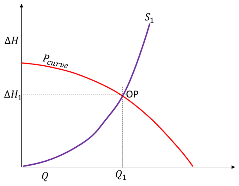

Yeah, at throat we need ##\frac{P_{throat}}{\rho g } < 0 ## to lift the fluid, and that also must also overcome the total head of the venturi line, so you have to be aware of static elevation changes and viscous head losses in the venturi line.
That implies that(ignoring head loss between the inlet of the venturi and throat - which is probably accounted for in the brochure values) at the very minimum:
$$ \frac{V_{throat}^2}{2g} > \frac{P_{inlet}}{\rho g } +\frac{V_{inlet}^2}{2g} $$
Really your goal is to get:
$$ \frac{P_{inlet}}{\rho g } < \frac{V_{throat}^2}{2g} - \frac{V_{inlet}^2}{2g} - z_{venturi} - \sum_{venturi~line} h_{loss} $$
The best thing to do is work with ##Q##( the volumetric flow rate) under the assumption of turbulent flow( approx. uniformly distributed velocity), hence:
$$Q = A_{inlet}V_{inlet} = A_{throat}V_{throat} $$
You solve for each of the velocities in term of the general ##Q##, and plug them in to the inequality above. That is beneficial because anything done with the pump curve is done with respect to ##Q## not ##V##.
I haven't looked at you pump curve yet, but what needs done is to create a system curve ##S_1## in the graph so that we can determine a pump that is suitable to give ##P_{inlet}##, at the operation point ##OP## (or a suitable venturi for the current pump and remaining system - piping, elbows, valves etc...)
Do you know how to generate a system curve? This might be a little mathematical effort, but unless you want to waste money purchasing venturis, or pumps I think it will be worth some effort.
