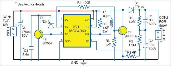

Say you want to choose a npn transistor which works for 1000V and 4mA (Peak inductance current is around 1A) in the collector side while emitter is grounded.
Which parameters should I look into to select a suitable transistor ? for the voltage should I be looking into Vbe ? or is Vce enough ? I'm thinking in this case Vce should be 1000V. For Vce (Sat) how would I calculate it when it's given for test condition (max or minimum sometimes both). For the current I should be looking into the worst case (peak current) ?
Will there be a problem if transistor which is designed for much higher voltage/current used for much lower values other than cost ?

Can you post the circuit schematic? With transient loads, things like Safe Operating Area (SOA) come into play.
https://www.sciencedirect.com/topics/engineering/operating-area
Also, if you can give us an idea of the signals that will be handled (bandwidth, rise/fall time, etc.), that will also help.
Will you be heat-sinking this transistor?

I have attached the diagram. I haven't designed the circuit so i do not fully understand every part of it but I get the jest of it, its from a project I found online which is HVDC power supply using DC to DC converter. The project is based on using a 12V battery to get 500V 2mA DC. The project also had a calculator which can measure the value of the components based on the output you desire. (You need to enter Vce sat of T1,Vin,Vout,Current,Diode voltage drop, and timing capacitor value). However I would like to adjust it to 1000V 4mA which means that I would have to change the transistor (T1) and find its Vce (sat). Diode used in the diagram will change too however I don't think will affect the calculations much if at all since the small voltage drop is small. I can link the project page if its allowed here.
Yes.
