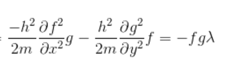

Yes, but I'm new to it. So I believe I should set the whole equation equal to a variable lambda, then the LHS would be
And do the same for the RHS where I would get two other separate equations, one in terms of f and one in terms of g? or would it just give:

Yes, except that you should think of ##\lambda## as a constant rather than a variable. To see this, note that your equation in post #5 must be satisfied for all allowed values of t, x, and y. So, suppose you arbitrarily pick a value for x and y. The right hand side is then some number. The left hand side is a function of time that must equal that number for any value of t. So, in fact, the left side must be independent of t. That is, the left side must be a constant which you can call ##-\lambda##.
See if you can construct similar arguments to show that the individual terms on the right side of the equation in post #5 must each be equal to a constant (although not necessarily the same constant.)

Ok, then the terms in the RHS would be
Where lambda is just an arbitrary constant
Is the problem finished like this?
OK. But, you should distinguish the three constants by not using the same symbol ##-\lambda## for each one. Also, there is no need to write the constants with a negative sign. In the Wikipedia link, they wrote the constant with a negative sign for later convenience for the particular partial differential equation there. In your case, you will discover whether the constants should be positive or negative as you solve the individual equations.
The three constants are not completely arbitrary at this point. The equation in post #5 gives you a relation that the three constants must satisfy.

Ok, then I can say
And so
And same for the LHS of the equation in #5
OK. These are standard differential equations which you can solve. How is the constant ##\lambda## related to the constants ##B## and ##C##? (Use the equation in post #5)
