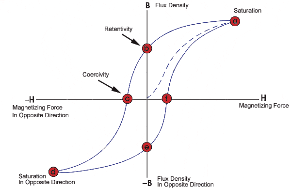

There are also losses in iron due to magnetic hysterisis in iron:
I think the hysterisis losses will be the same, laminated iron or not. But anyway:
