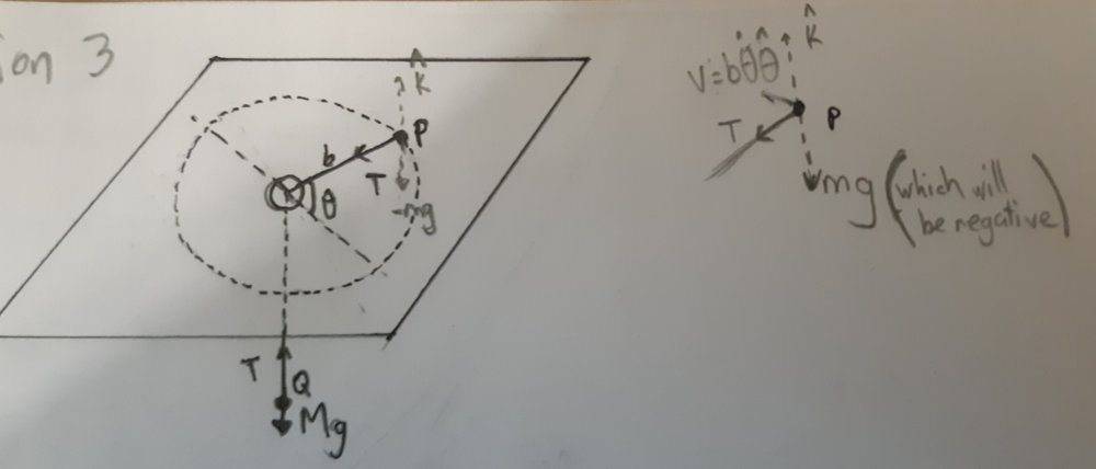

This is the free-diagram and the picture that I have drawn. I see did not include the i and j axis on the picture.
The two forces that are perpendicular to the table are the $$\vec F = -mg$$ and the unit vector $$\hat k$$
I think the third force would be the tension, T, on the string? Would the tension not then be T = -mgsinΘ ?
Would the equation be $$F(net) = \hat k -T - mg$$
Then $$F(net) = \hat k +mgsinΘ -mg$$
Your diagram is OK except that ##\hat k## is not a force, it is just a unit vector pointing perpendicular to the table. However, there is a force acting upward on P in the direction of ##\hat k##. Can you state the name of this force?
##\hat k## is the same unit vector as ##\hat z## that I used in my previous post. Feel free to use either notation. I will switch to using ##\hat k##.
When you write ##\vec F = -mg##, you can see something wrong here. The left side is a vector, but the right side is just a number. If the left side of an equation is a vector quantity, then the right side must also be a vector quantity. The correct way to write the gravitational force acting on P is ##\vec F_{grav} = -mg \hat k##. The unit vector is a necessary part of the right hand side in order for the right hand side to have both a magnitude and a direction.
Likewise, when you identify the force that acts upward on P in the ##\hat k## direction, you can write it in terms of the unit vector ##\hat k##.
Yes.
No. You already know the magnitude of ##T## from your consideration of particle Q. Can you use one of the unit vectors ##\hat k##, ##\hat r##, or ##\hat \Theta## to indicate the direction of the tension force?
It should be the normal force. $$\vec F_N = mg\hat k$$ I think it should be positive since it is a force acting upward.
Yes, it's the normal force, ##\vec F_N = F_N \hat k##. But how do you know that the magnitude of the normal force is equal to ##mg##? It is worth going through, in a logical manner, how to deduce the magnitude of the normal force. You might think I'm being unnecessarily pedantic. But you can use very similar reasoning when working with the ##\hat r## and ##\hat \Theta## directions. We apply Newton's second law along the z-direction (i.e., the ##\hat k## direction): ##\sum F_z = m a_z##. From the free-body diagram, we see that ##\sum F_z = F_N - mg##. So, Newton's second law for the z-direction is $$ F_N - mg = ma_z$$.
We are told that particle P moves in circular motion on the table. Therefore, it never changes its vertical position. Thus we conclude that ##a_z = 0##. So the second law equation reduces to ##F_N - mg = 0##. Thus, we have deduced that ##F_N = mg##.
Similar analysis for the ##\hat \Theta## direction will allow you to show that P must move at constant speed. From analysis of the ##\hat r## direction you can deduce the value of the speed.
The tension is along the $$\vec r$$
This is not quite correct. The unit vector ##\hat r## is defined as pointing "outward", away from the origin (the hole in the table). But, as you correctly show in your diagram, the tension force on P points "inward" toward the hole. So, the direction of ##\vec T## is ##-\hat r##. So, the tension force is ##\vec T = -T \hat r##.

Nicci said:
##0 = m\vec a_Θ = m(b\ddot Θ \hat Θ)##
Good. Can you determine anything about ##\ddot \Theta## from this?
Yes, ##\ddot \Theta = 0## and if it is equal to zero, then ##\dot \Theta## is a constant. So Particle P has constant speed. Now I can say that ##u = b\dot \Theta##
