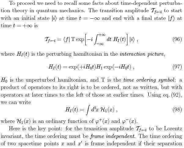

I am studying Srednicki's "Quantum Field Theory", section 4 "The spin-statistics Theorem".
Does anyone know how to show that "The time ordering of two spacetime points x and x' is frame independent if their separation is timelike."(P32), explicitly?
And "Two spacetime points whose separation is spacelike, can have different temporal ordering in different frames." How to show this?
Thanks

Thank you for your reply. But my question is how to show "the time ordering operation" of two spacetime points x and x' is frame independent if their separation is timelike.
I attached the following paragraph from Srednicki's book for your reference. Please click the attachment for clarity.
you need Δt' to be the opposite sign of Δt
