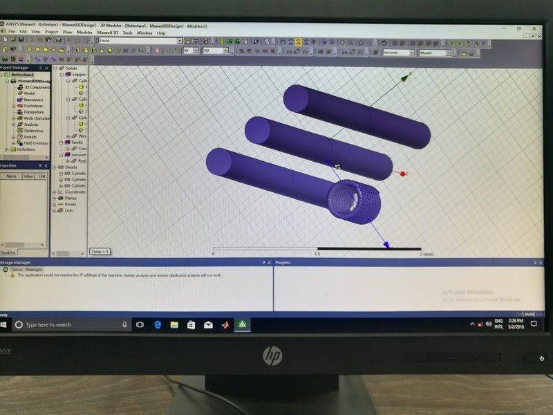

Hey, i am having "current leak to the air" error. Kindly help me regarding that what is the actual problem. I think it as about region. When I simulate without three conducting wires it simulates but when I simulate with conductor current leaks.
