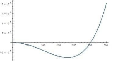

What is wrong with the numbers? ##x=0## is unstable in this case and the oscillation will be around a minimum ##x \approx 170##. We can start from any ##x(0)##between 0 and 250. Here is the plot of the potential energy given the parameters:
Well in principle you can start from anything really. But choosing your important parameters with16 orders of magnitude difference can be complicated for the numerics.
