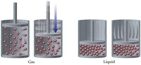

No, a simple counter example can demonstrate that, illustrated as follows
Say we have a piston filled with a gas at time t0. Next we push the piston downwards and the gas compresses, say this is time t1. So, the mass density of the gas increases over time, ##\frac{\partial \rho(x,t)}{\partial t} \neq 0##. The piston goes downwards with very low velocity, so the Mach number is very low, so the gas' flow is still in the incompressible regime. A liquid on the other hand would not compress, and for a liquid ##\frac{\partial \rho(x,t)}{\partial t} = 0## holds.
