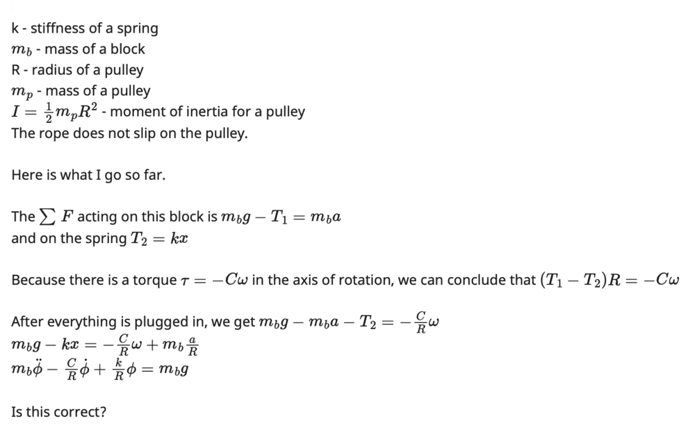

Write a differential equation for a mass-spring system.
F=ma
bolzano95 said:
There is no friction between the rope and pulley.
You don't mean that. A frictionless pulley means there is no friction at the axle.
If there were no friction between pulley and rope the pulley would not turn; the rope would just slide over it.
A few mistakes towards the end.
Torque = moment of inertia times.. what?
A factor of R seems to have disappeared somewhere.

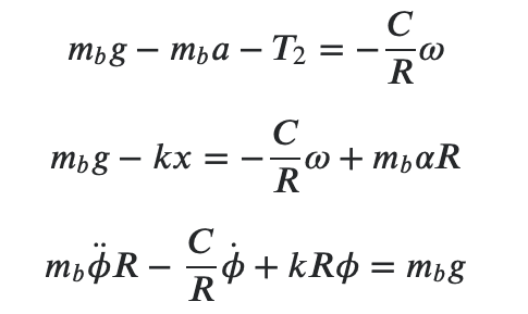

Sorry, I meant the rope does not slip on the pulley.
I fixed the last equations and double checked the R-s. But I'm still confused by what you mean with
Torque = moment of inertia times ... what?
The torque in this case is given as a product of C and angular velocity, where C is a factor of dampening.
Is this correct?
Torque has dimension ##ML^2T^{-2}##. Moment of inertia is ##ML^2## and angular velocity is ##T^{-1}##. Multiplying those last two gives ##ML^2T^{-1}##, not torque.
There is no damping here (much less dampening - all is dry). The forces are all conservative.
I checked the torque and I agree there is something wrong, but unfortunately I have to use the given formula (it's mandatory). But I think that in the coefficient C are hidden necessary units.
I suppose that the goal of this problem is to write a homogeneous linear differential formula, but what I get is a nonhomogeneous one. So I just wanted to check if my solving process is correct.
Either you were given the wrong formula or you have misunderstood.
The equation is ##\tau=I\alpha##, torque equals moment of inertia times angular acceleration.

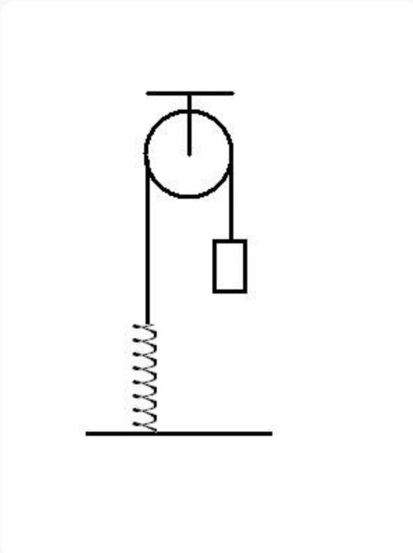

The statement “... there is a torque in the axis or rotation” suggests to me that the shown diagram does not correspond with the text of this problem.
Good point.
@bolzano95, does that statement correspond to a part of the problem statement that you have left out? I.e. your ##-C\omega## term is correct but your error is that you left out the ##-I\alpha## term from the torque difference?
I remain doubtful of that because axial friction should be ##-C\frac{\omega}{|\omega|}(T_1+T_2)##.
Edit: added tension factor above.
