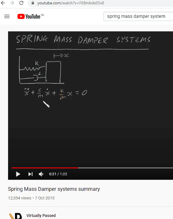

Is it possible to solve a spring mass damper system manually? Pl. show some examples?
The other day when I solved a spring mass damper system in Matlab, I was curious how in olden days would have people solved the equation. We all know the 2nd order differential equation of the system:
However if I know the time, damping coefficient, stiffness and mass, will I be able to find 'x' manually? Are there some examples? I referred to my old engineering engineering textbook and failed to find a suitable example.
Hi,
The way you found it on utube is the same way you can find the damped oscillator ! Once you've read all that, the solution isn't far away !

The general way to solve such a thing is to try solutions like ##A\,e^{kx}## and see what you need for ##A## and ##k## to satisfy the equation ...

Thanks BvU. I referred to the "solution" page you recommended where they start solving the differential equation assuming the solution is of the form "x = Ce^(λt)". So if this equation directly gives a simple solution for the position of mass x, the 2nd order differential equation that includes mass, stiffness etc. becomes redundant, right? We only solve "x = Ce^(λt)" and find x and other derivatives. Why did we write a governing equation at all?

Sorry my bad. Yeah the characteristic equation. Once we know it is a second order differential equation, is it no longer needed? Can we describe the whole system with the assumed solution "x = Ce^(λt)"?
No. At a minimum it would be ## C_1 e^{λ_1t} + C_2 e^{λ_2t} ## but we still have to investigate if the ##C## and ##\lambda## exist, and -- if so -- how many (cf critical damping case). And they have to be linked to the parameters and the initial conditions.
