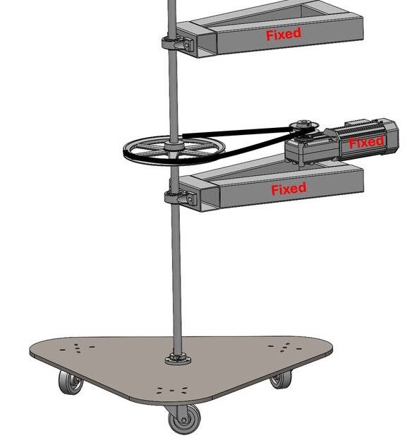

I am designing a system to test floors, called the "Robinson-Type Floor Test". I have the basic design below, but I'm having trouble determining how exactly to spec the motor here. The large pulley on the rotary shaft is 12in in diameter and the small pulley on the motor is 3in in diameter. At most, the carriage will be holding 900 pounds (300lbs on top of each wheel). The wheels underneath the carriage will be hard rubber or steel. The surface that the wheels will be rolling on will be various different smooth tiles. The pulleys are heavy-duty v-belt pulleys. The carriage (the assembly) needs to rotate at a constant 15±0.5 RPM.
The distance from the center of the base plate to each wheel is 15in, and the rounded corners of the triangular base plate have 6in radii. The base plate is a 1/2in thick hot rolled steel plate. The rotary shaft itself is 60in tall, to give a sense of scale here.
Any advice? Trying not to go overkill and spend way too much on a motor, but I also don't want to buy a motor that's too weak.
Help is appreciated, thank you!

Since the RPM is specified, only the torque is needed to compute the power required. The torque will depend on the highest frictional drag floor you will need to test. For that reason, you can use the same power rated motor as any other similar tester. The power needs to be sufficient, excess power will increase the range of the machine to test softer floors.

- you can give an estimate to the rolling friction, then calculate a required force based on the expected load: at the end of the day you will get a power requirement which you will double for safety margin, and so you will have it with the certainty of a decent guesswork, for the price of a never-again-used math exercise. And still, all the numbers can be wrong, of course.
- you can check the datasheets of electric trolleys with some similar-looking wheels and 1000kg load capacity: what kind of motor do they use? ....and then you can choose a bit bigger one.
I would say something around 0.8-1kW. With good cooling.

Perhaps you could give us a link to an actual explanation of what the test actually involves. All I can find is websites that assume you already know what it's all about. Is it a strength test or a test of sound insulation? Cheers
Also, your diagram seems not to include bracing to improve how that single rod would behave during 'violent?' oscillations. Could you comment?

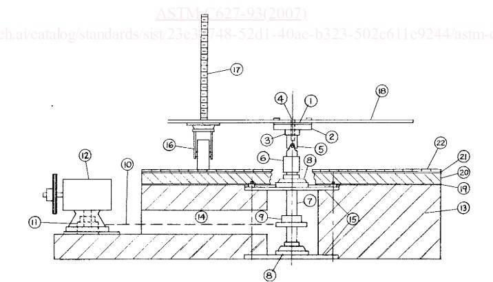

Then you NEED a copy of the current ASTM standard that was linked in Post #5. That ASTM standard specifies how to design the Robinson test fixture. You need to build the test fixture exactly to the ASTM standard in order to have test results that other people will accept.
The image below was copied from an obsolete copy of that ASTM standard. It looks nothing like the sketch in Post #1. You need to start over with a current copy of the standard, which costs only $75.00. That cost is cheap compared to the cost of the test fixture, and extremely cheap compared to the cost of building a useless test fixture. Note that the ASTM standard tells you exactly what motor to buy.

3/4 HP was specified, and there is no reason why that has changed. You will need to select a gearbox, chain or belt reduction to give 15 RPM. The line frequency will determine the induction motor RPM.
