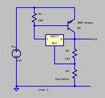

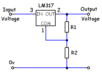

We know Voltage across R1 (see image 1) is 1.25V. So if I take the output across R2 rather than at OUT of IC, won't I get variable voltage from zero volts? Why not people do this? Does this effect regulation in any manner?

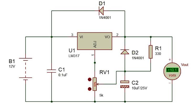

Refer image2. We can add addition capacitor and two diodes for short protection and further stabilization? How do they ger changed if I use my method of taking output across R2?How can I increase the current output above 1.5A? I've seen ways of adding a transistor. How would that work here in case of taking output across R2?

I started to think if I apply load across R2 the current it needs should come from R1 but ideally Curreny thru R1 is constant. Thus regulatuon will be destroyed. Isnt there another way to getting from 0V output where I can apply those additional capacitor and diodes for protection and additional stabilization and also I can increase current output much over 1.5A.
Regulated output is from LM317 out terminal. If you load the potential divider Adj terminal it will no longer be regulated.
To regulate at zero volts you need a 1.25 V negative supply or a 1.25 V drop after the output.

To boost output current you can use a pass transistor. When current through the LM317 rises towards one amp, the voltage across R1 turns the transistor on and provides more current.

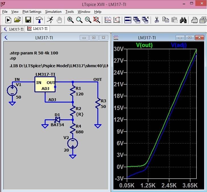

I speculate that even if a negative voltage far below -1.25V is applied to the ADJ pin, the output voltage of this TI example circuit will never become negative.
Therefore, I performed an accurate circuit simulation using TI's LM317 SPICE model and confirmed this assumption 😀.
Negative voltage changed from -10V to -20V in order to produce a negative voltage much lower than -1.25V for the ADJ pin.

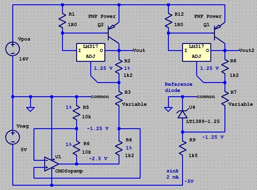

The problem with a resistor to the negative supply is that regulation is unreliable and supply noise appears on the output.
Here are a couple of quieter solutions.
The first uses the constant reference current and an op-amp to generate a negative reference voltage.
The second uses a voltage reference diode, biased with sufficient current to a negative supply.
Likes Tom.G
