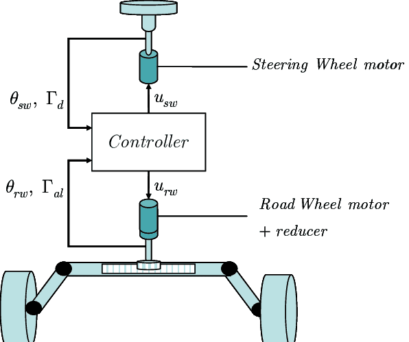

i have a steering wheel mounted on an electric motor, and i want to stop the driver from going beyond a certain angle. i can read the torque applied by the driver, and the steering wheel angular velocity as well. how can i stop the steering wheel, without sending it harshely in the opposite direction?

I'm working on a system called "steer by wire", basically there is no mechanical link between the steering wheel and the road wheels(see image atteched). but i think it doesn't change much to the problem, all i wanted to say is that there is a permanent torque that turns the steering wheel in direction, and what i want to do is to produce the effect of a "mechanical stop" once the driver goes beyond a certain angle.
the first idea i had is to generate the same torque of the driver in the opposite direction :
if(SW_angle>=angle_limit) trq_cmd = -(driver_trq)
but it seems to be very powerfull and turns the steering wheel harshely in the opposite direction.
i think I'm missing something in the principles of dynamics, and i souldn't look at the problem with static principles.

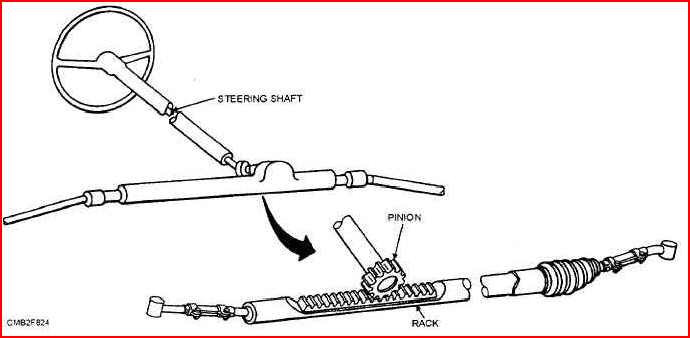

I don't think I'd use torque as a control or feedback variable in this SBW system. I would approach it using the steering wheel's angular position and reflecting that into the horizontal position of the rack in the steering mechanism. Power steering in modern cars already makes the feel of the steering wheel very light, with little reverse torque to re-center the steering wheel position. You could add a small spring with damping, I suppose, return the whole system to center slowly if the steering wheel is let go of.
Have you considered a position-based SBW system instead?
http://constructionmanuals.tpub.com/14273/img/14273_312_2.jpg

the SBW system already exists. What i want to do is to add some haptic feedback functionalities to it. in this case i want to simulate a "rubber stop" to prevent the driver from going beyond a certain angle.
