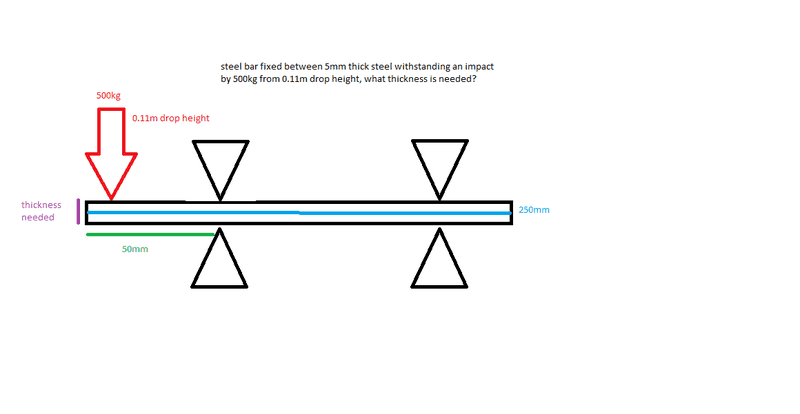

Hello, new member here so first post, I apologize for any unintentional faux pas.
Anyway...
I have a problem which I have been asked to sort out in my work place. We have a rig which is used to move a pneumatic ram up and down. Currently it is on an electrical winch system and I have been tasked in finding a way to make this safe for people working under it by having a secure safety system in place just in case the winch fails. The easiest way that I can think of doing this is by having a pin pass through the two outer edges of the RSJ it is attached to and go under a protruding piece of steel work of the movable section, as shows in the image below:
What I need to do is stop it dead in its tracks, if the pin bends and jams under the movable part of the rig that is fine, it can be sorted later. What it cannot do is break the pin upon impact. The numbers I have gathered from varying sources are below, all i want to know is what is the thickness of the pin that i need?
O.k. I am assuming a weight of 500kg, this is a lot and much more than what it actually weighs but if i overestimate then I have a little wiggle room.
The pin will have the following characteristics:
  • A density of 7.85g/cm3
  • A length of 250mm
  • The impact point on the pin will be 20mm in from the end which is unsupported by the RSJ
  • The bend point will be where the pin goes into the first upright of the RSJ at 50mm from the end.
  • The steel has a yield of 250MPa
  • An ultimate strength of 400MPa
  • I think the modulus of elasticity is 30.3Mpsi
It has to withstand a weight of 500kg falling 110mm. The fall will have the following characteristics:
  • Time to fall: 0.149779026187 seconds
  • Velocity: 1.46883048716m/s
  • kinetic energy: 539 joules.. or 539kN worked out using the following formula:
  • mass x gravity x height = 500 x 9.8 x 0.11 = 539
If anyone could help I would appreciate it. If any of the numbers do not seem right in your eyes please tell me and I shall investigate further. I think I have everything i need to do the maths but I can't figure out how to do the maths. Every example I have seen has the impact in between the supports and not outside them, so just to clarify I have attached another diagram below which should make it clear what I am after:
On a separate note, would the shape of the pin in question make a difference? I.e. a hex shaped pin, or a more square one rather than a cylinder? Also I read somewhere that boring a hole through the center of the pin could strengthen it for this type of impact due to the larger surface area, is this true?
Sorry for all the questions. Hope to hear from you soon, if you need any more info please ask.
It depends on the amount of deformation desired (reference). Normally, you would want the pin deformation to stay in the elastic zone of the material. So, the transverse displacement ##\Delta x## can be found with the definition of the Young Modulus:
[tex]\Delta x = \frac{Fl}{AG}[/tex]
Where ##F## is the shear force, ##l## is the initial length, ##A## is the shear area and ##G## is the Young Modulus. Also:
[tex]F = \frac{\tau_y}{S_f}A[/tex]
Where ##\tau_y## is the shear yield stress (that we do not wish to exceed to stay in the elastic zone) and ##S_f## is the safety factor.
The amount of work done (##F \Delta x##) is equal to the energy input:
[tex]mgh = F \Delta x[/tex]
[tex]mgh = \frac{F^2 l}{AG}[/tex]
[tex]mgh = \left(\frac{\tau_y A}{S_f}\right)^2\frac{l}{AG}[/tex]
Or:
[tex]A = \frac{S_f^2 Gmgh}{\tau_y^2 l}[/tex]
That would be the pin shear area needed.
To be noted:
  • The force is actually an average force during the displacement ##\Delta x##, so it may have higher peaks. A higher safety factor may be required without testing.
  • This assumes that only the pin deforms. If there is more deformation involved i.e. the part that hits the pin (and it will deform as well), this adds up as a safety margin (##F## will actually be smaller since both ##\Delta x## combined will be larger).

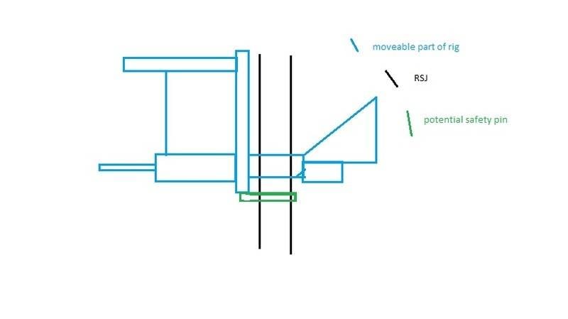

I am a little confused by your description. Are you using the winch to move the ram and the ram provides a separate function or is the ram somehow supplemented by the winch and the ram provides the primary function? Also Are you talking about a regular work process or is this a safety procedure for maintenance persons?
As to the calculations notice that the kinetic energy developed increases rapidly with fall height. If you can reduce that the gains are significant. Another idea if in fact you are talking about the ram and not the winch. A standard maintenance item for workers with Hydraulic and pneumatic rams is to use a steel channel that fits around the pushrod. The piston is extend to slightly past the desired position, the channel is then placed around the ram. This is locked in place with a non load bearing pin or keeper. The ram is then retracted to alleviate the load and also reduce potential fall height to 0. This style preventer can often be placed by a single person and support high loads for maintenance.
Instead of a pin you could use a flat surface made of iron or similar.
No way any small falling object will break through that.
The ram is not part of the lifting mechanism at all, that is all done by electric pulley. It's a safety procedure for regular use of the device the ram is used to apply loads on a vertical surface and quite regularly needs to be raised above head height and it is not uncommon for people to have to work under it. It's the type of thing that if the pulley failed due to a bolt sheering or cable fraying then a hardhat would do little to protect the person it fell upon.

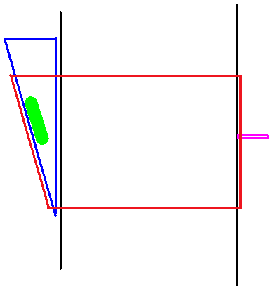

Hi
I suggest a wedge as shown below. The unit could be moved to a desired height and protect the product when in use.
Black = RSJ
Red = wraparound collar.
Pink = set screw
Blue = wedge
Green = permanent magnet
Ideally there should be some sort of interlock so that people cannot work under the weight unless the safety device is in place. Perhaps a gate lock that is only energised when the safety bolt is fully engaged. Should also fail safe in the event of a power cut etc
ikeatwork said:
in the first equation it asks to use A and in the last equation it tells you how to work out A but you need to have some of the numbers worked out previously to have this equation make sense. Am i doing this utterly wrong?
Only the last equation is needed: ##A = \frac{S_f^2 Gmgh}{\tau_y^2 l}##. You should know all of these variables.
Note also that this assumes that the distance ##l## is a for rigid bar. Looking at your drawing, if we take the pin as a beam, the displacement ##\Delta x## can be greater and it would be represented by ##y_{x_1 = a}## (see reference) or:
[tex]\Delta x = \frac{Fa}{6EI}(2aL+3a^2 - a^2) = \frac{Fa^2 (L+a)}{3EI}[/tex]
In this case:
[tex]mgh= \frac{F^2 a^2 (L+a)}{3EI}[/tex]
Or:
[tex]F^2 = \frac{3EImgh}{a^2(L+a)}[/tex]
In your particular case where the pin is round, ##I = \frac{\pi r^4}{4} = \frac{A^2}{4\pi}##. Thus:
[tex]F^2 = \frac{3EA^2mgh}{4\pi a^2(L+a)}[/tex]
The shear stress is ##\tau = \frac{F}{A}##, thus we can determine that:
[tex]\tau = \sqrt{\frac{3Emgh}{4\pi a^2(L+a)}}[/tex]
Or:
[tex]\tau_y \gt S_f \sqrt{\frac{3Emgh}{4\pi a^2(L+a)}}[/tex]
Furthermore, in this case (beam), we have to consider maximum stress due to bending moment (see reference) where ##n = r## and ##r = \sqrt{\frac{A}{\pi}}## for a round beam, thus:
[tex]\sigma_{max} = \frac{n}{I}M_{max} = \frac{\sqrt{\frac{A}{\pi}}}{\frac{A^2}{4\pi}}Fa = \sqrt{\frac{16\pi a^2}{A^3}F^2}[/tex]
[tex]\sigma_{max} = \sqrt{\frac{16\pi a^2}{A^3}\frac{3EA^2mgh}{4\pi a^2(L+a)}} = \sqrt{\frac{12Emgh}{A(L+a)}}[/tex]
Or, if we set the maximum stress to the tensile yielding stress + the safety factor (##\sigma_{max} = \frac{\sigma_y}{S_f}##):
[tex]A = \left(\frac{S_f}{\sigma_y}\right)^2\frac{12Emgh}{L+a}[/tex]
I did not check, but this should give you a smaller and more realistic value.

(1) It would be better to arrange the design so that the load can't actually fall at all or at least not very far .
(2) Common arrangement is to have a selection of holes so that pin can be placed in best location .
(3) Ideal arrangement is to have just one or a small number of pin locations and to lower the load under control until it seats on the pin .
(4) Putting a pin through plain holes in an RSJ is not good practice . Ideally have some reinforcement to maintain the strength of the beam and to provide some seating area for the pin .
The rig can be raised over 3m, there is a hole every 100mm.
See above.
Not possible due to the nature of the work.

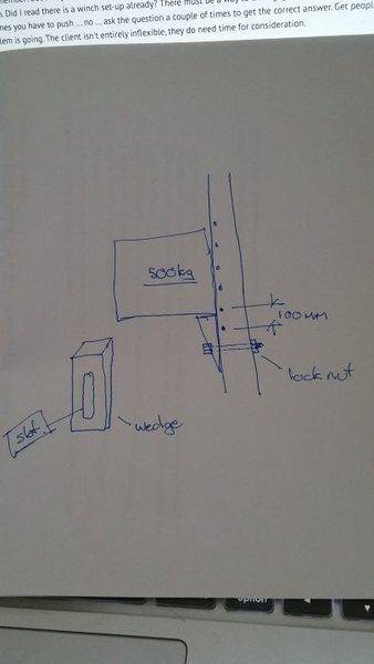

What would you suggest? I am looking into the wedge system described in Terrysv's post. I am attempting to work out the formulae in jack actions posts. I have thought of having a u shaped steel pin going through two of the holes in the RSJ to the stress of anything falling is spread over the two points and there is less chance of the steel bending, I think. Another option is to have an adjustable chain looping over the top of the rig and down under the movable part to catch it but then you are replying on a chain and don't know if there are any weak links. Any other options tend to get more complicated. I am after a simple solution to a problem so that if it breaks then it is 1. easy and 2. cheap to fix.
The current safety device is not adequate at all really. I want myself and others in my work place to feel safe when working around it.
(1) The simplest solution of all is just a system of props . Very commonly used is a selection of lengths of railway sleeper . May need a pair of opposing wedges to get small height adjustments and lock the prop in place .
(2) Anecdote - I once designed a high speed high loading hydraulic arrester device . A prototype had to be impact tested to validate the design . Not many suitable test facilities in UK but something suitable was found in the Railway Research Centre at Derby . They had a very big drop hammer , instrumentation and experience of conducting this sort of test . I was intrigued to find that the drop hammer probably dated from the 1920's at the latest and would originally have been steam driven . It had now been adapted for modern work with electric hoist and greatly extended slides to give longer drops . They just used pieces of sleeper and bits of RSJ as safety props .
(3) If you decide to stay with pins then ideally they need to run in tubes welded between the RSJ flanges . Probably easier in practice to weld drilled square blocks rather than round tubes .
(4) I would be tempted to at least look at a device which bolted through any set of adjacent holes . Work of a couple of minutes to bolt in place and unbolt afterwards . Doing it this way you could have a catcher system of immense strength and functionally better shaped than a round pin .
Actual catcher piece could then be a solid rectangular block faced with a thick buffer layer of industrial rubber and optionally you could have have some metal slip pieces that could be put into reduce the gap between load and catcher to zero .
A difficulty is that you would need to work out a configuration that allows you to bolt the parts in place without needing to work under the temporarily unsupported load .
(5) PS: Energy methods are useful when sizing pins to withstand impact loading .

Terrysv said:
2. Make a wedge with a pin to be placed in a hole below the rig. Instead of bending the pin the wedge will be jammed into the 20mm space.
Along with some means of keeping it in place under vibration (and gravity), it seems one of the better ideas. Still have to figure out how to position it safely.
The larger mass is below the pin to let gravity hold the wedge in the proper rotation.
A cotter pin could also be used to secure the unit.

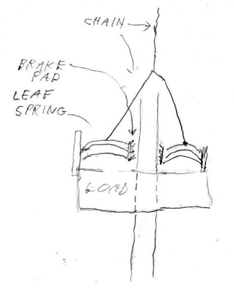

A different approach.
Here is a concept sketch for automatic braking. The spring strength and brake pads must be sized such that each one alone can stop the load. For redundancy, use two concentric springs on each side (wound in opposite directions), each strong enough to stop the load. If the implementation is easier, use leaf springs instead of coil springs. Of course the braking end of the leaf spring will have to be held down but allowed to slide.

I think the bolted wedge is a dangerous solution. The wedge will multiply the tension in the bolt, which will fail in tension, before it would have failed in shear.
A self locking cam that is activated when tension is released if the wire or suspension system breaks, requires no adjustment, is automatic and is safe. The supported mass will never fall more than a few inches as the cam engages, there will be little impulse. It is proven a solution.
Ah, well back to the drawing board. Where would I find a self locking cam from?
Invert the problem . Have a sprung loaded pawl on the moving load and a square peg located at each of the existing pin holes . Pawl is sprung so that it will always catch a peg if load drops . To use hoist for normal purposes pawl is temporarily pulled out of position by an operator so that load can move freely up and down .
Don't give up on pin based devices either .
Instead of the simple single pin think about a short section of (bolted together) square tube which encloses the vertical RSJ .
Raised to a suitable height from a parking position low down it is locked in place by pins in two adjacent hole positions which go right through square tube and both RSJ flanges . The actual catcher is a strong lug welded to the working side of the tube .
Optionally with buffer layer of several thicknesses of tyre material .
Also optionally square tube can have extra pin holes at closer pitch than basic pitch in the RSJ thus allowing for fine positioning .
