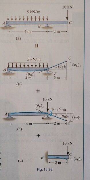

In summary, the book tries to explain that the situation pictured in (a) is equivalent to the superposition of the situations pictured in (b), (c) and (d).

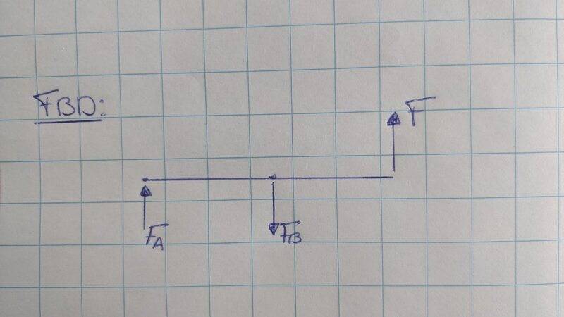

I have to calculate the deflection at the end of a beam due to a force. How do I find the moments in a beam while their are only forces applied (with pivots/hinges).
Sigma_bending = F*L^3 / 3EI
Theta = M*L / 3EI
Hello!
I have to calculate the deflection of a beam at at given point (C). The books says the should be a moment which plays a role in this deflection. How does this moment occur? I have drawn a FBD but couldn't find a moment? Should I divided the beam into separate parts or so? What am I missing here?
Thanks!

What do you exactly mean with balance of moments? I think I know what you mean but then there should be another moment due to the Fa force (Fa*a = Moment)?
I can't see their is a moment because the beam isn't clamped, it is only supported by rollers and a pivot? Bit confused here...o_O
The book also stated that we can move the force F at the position of pivot B. They actually separate the beam with moving force F on pivot B and add that moment. How is that possible?
You have not shown any weight of the beam. Show it as a distributed load. If it is massless it won't bend. It won't even stay on the supports!

A picture, but I have simplified it a bit in the first post because I only didn't get that figure 12.29c:
Please, note that the directions of the force applied on point C are opposite in your diagram of the first post and in the book's picture; that changes things.
It seems that the book tries to explain that the situation pictured in (a) is equivalent to the superposition of the situations pictured in (b), (c) and (d).
What I meant by colinear was that, as represented in situation (c), there is no distance between the lines of applications of the forces F and reaction force at B; therefore, there is no moment induced by F or Ryc at pivot C, and an imaginary suplemental moment has needed to be introduced in order to keep the beam bent as in situation (a).

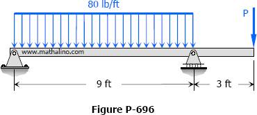

Please see method 5 and related typical problems in this link:
https://mathalino.com/reviewer/mechanics-and-strength-of-materials/chapter-6-beam-deflections
Once you get the concept, we could draw a diagram of forces and moments together.

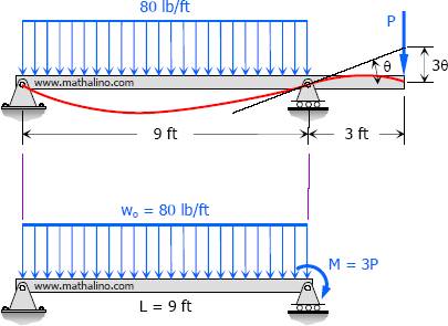

The attached diagram copied from the website of the above link explains it better than I could.
The deflection of the beam for the length between the supports is going to be the same for either case.
That deflection, regarding maximum value and shape adopted by the beam (see red line) within that lenght, is different from the natural deflection that would be adopted by the beam under the distributed load alone.
The reason is that either the shown concentrated force or the shown punctual moment are helping that length to deform less.
There is a distance between the F and reaction force in B, 2 meters? Ryc is a virtual reaction force at C? We have actually two deflections in point C as shown in the pictures (c) and (d), Vc2 and Vc3. But Vc2 is already the total deflection of point C isn't it? Sorry my English isn't very decent, maybe that's why I can't follow you, excuse me for that.
I thought I was quite familiar with the "superposition method", but that was for beam without an overhang. Looks like it is a bit more complicated..
