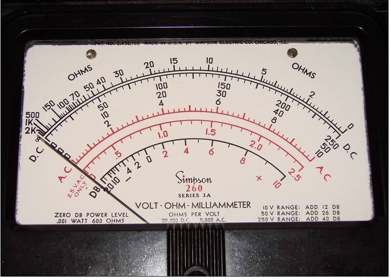

Yes they can be tested on an ohms setting.
On better analog meters that have a RX1 scale, one should use the RX10 setting NOT the RX1 scale.
That's because analog meters can apply substantial current when selected to RX1, like ~150 milliamps, which can wreck a small signal transistor.
A good junction will give about 2/3 scale deflection
a shorted junction will of course give full scale deflection , zero ohms
a Darlington transistor's E-B will give about 1/3 scale deflection because it's two junctions in series.
One should avoid the highest resistance scale, RX10k on the Simpson pictured, because most analog meters when selected to that scale apply in excess of 6 volts which exceeds the reverse E-B limit for most transistors.
We've had threads about how analog ohm-meters work in EE forum.
One can extract a lot more information fromhis meter if he understands its inner workings.
if there's interest , re-open or start another one ?old jim

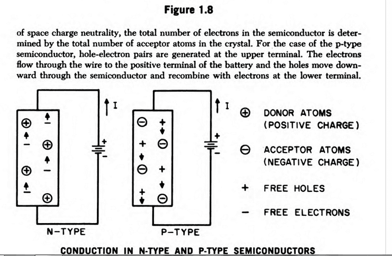

In vacuum tubes electrons actually do leave the cathode and arrive at the anode , aka plate.
My 1958 GE Transistor Manual introduces transistors by using parallel to a triode tube
from page 7
Here the emitter emits electrons, the collector collects electrons and the base controls the flow of electrons by controlling the charge concentration in the base region, so in the broadest sense, the function of the three elements in the triode tube and the transistor are similar..."
My high school textbook was the 1962 edition of the GE transistor manual. Found it online here
http://babel.hathitrust.org/cgi/pt?id=mdp.49015000619008;view=1up;seq=24
Observe they speak of electrons flowing... page 10
Since textbooks and indeed the GE manual used conventional current for all formulas we boys became ambidextrous , able to work with either current convention. I won't say ithat was painless.
But we did our basic thinking with the electrons for charge carriers because they're the particles that actually move. That was common in 1960's.
