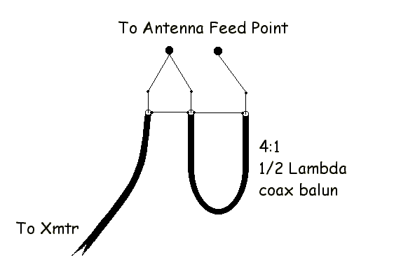

Also, others earlier on commented about impedance matching, this isn't much of an issue either
use 50 Ohm coax and a 4:1 BALUN ... I did one on this forum for some one else recently will see if I can find itDave
Likes Shubham Jaydeokar and berkeman
OK here it is ...
and some info to go with it
again for this BALUN, the loop is 1/2 wavelength at the freq of use
Ohhh I must state too, to save confusion, the lengths mentioned ... the 1/4 sleeve and the 1/2 wave loop ... these are an electrical 1/4 and 1/2 wave for the coax used. If a freespace 1/4 and 1/2 wave are used, the lengths will be too long
An example
freespace 1/2 wavelength at the 144MHz Amateur band calc ...
1 wavelength in metres = 300 / freq (in MHz) = 300 / 144 = 2.08 metres
1/2 wave/length = 2.08 / 2 = 1.04 metres
Electrical 1/2 wave = 1.04 x the Vf ( velocity factor of the cable)
1/4 inch diameter RG58U has a Vf of about 0.66 therefore
1.04 * 0.66 = 0.6864 metres (68.64 centimetres)
Dave

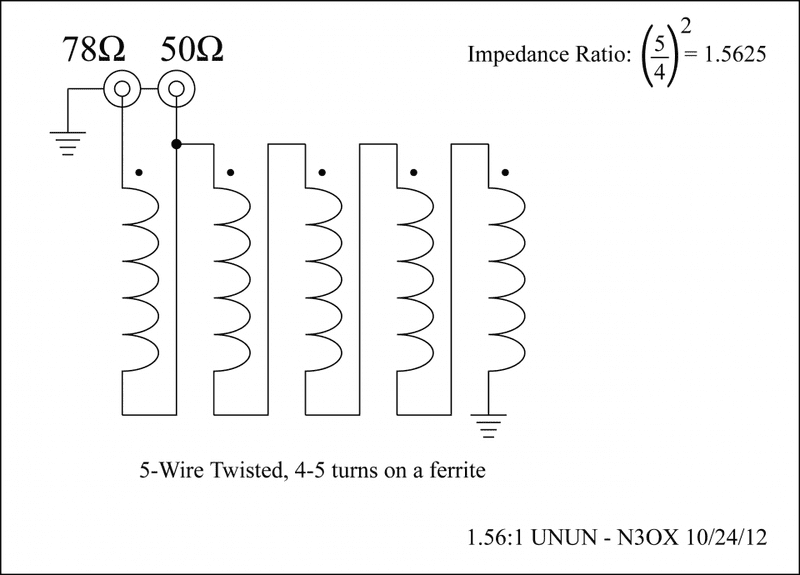

So best to use something like a 75 ohm to 50 ohm transformer with an SDR receiver so you can watch the doppler shift on the computer screen. I believe that the ISS is operating on 145.8 MHz as a digital packet radio these days. A cheap SDR should be able to handle that demodulation and display with free software.
Attached is a picture from the web that shows a 78 to 50 ohm "UNUN" which will need to use a couple of turns of five-filar twisted wire on a UHF ferrite core, (pinched from a TV BALUN). The example attached was for HF.
Likes Shubham Jaydeokar and Averagesupernova

show a close up of the coax termination point
Yes.
The combination of a simple SDR and a computer software can get me done with the experiments' aim.
When this problem regarding a balun and a connector is solved, then I'm going to turn on this topic(FM Demodulation of the received signals using an electronic circuit).
Thanks for your help.:thumbup:
