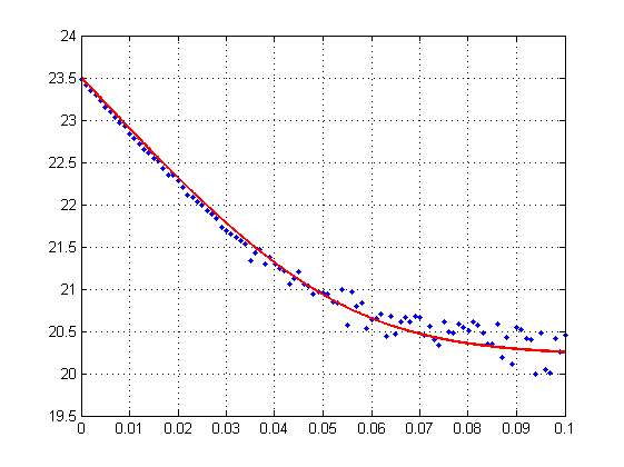

In my code, I changed two lines:
Code:
plot(t,log(y),'.');
plot(t_fit,log(y_fit),'r','linewidth',2);
And the plot is:
But I have doubt, is it right? I mean, is this what I need? What is the sense in this operation? I thought that firstly I should convert simulated y-values to log-scale, and then perform fitting with new, logarithmic function - fit logarithmic function to transformed y-values, is it right?

I tried the following:

The plot is:
I.e. firstly I converted simulated y-values to ln(y), and then performed fitting with function log( a*exp(-t/b)+c ), and it is seen that fit is not good.
Found parameters in this case are the following:
Code:
a=1.550000e+10; b=0.0156; c=6.000001e+08
So for me, transition to log-scale doesn't make sense.
Problem being the constant present, and the weights of the individual points. In the normal fit the points values had equal weights. In the fit of the log the low values get disproportional weights.
