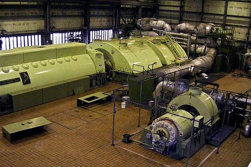

Not to go off topic, but this worked for me when implementing Automatic Generation Control (software PID control) for this (X 3) and the other energy center's generators. And slowly is the key word here.
