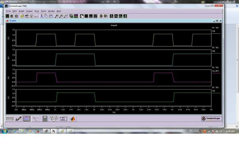

please have a look at the circuit , it is i believe a dual rail domino gate, i want to determine the output Y and Y'.. i used hspice to be sure that i didn't make any silly mistake. here is the hspice output in cscope.. (i used vector file to give inputs to A and B and the input vectors of A and B are like - 00,01,10,11,00,00,00,01,10,11,)
now, the truth table of this compound gate is -
A B Y Y'
0 0 0 0
0 1 0 1
1 0 1 0
1 1 1 0
i am a bit confused what logic it actually implements... the Y is always equal to A, and Y' is equal to B for first 3 inputs.. can u please throw some insight ? :)

  • #60
I'm not sure exactly what it is either, but your analysis is incomplete. If A and B are both low, then Y and Y' are both low as you have it. However, when A and B are both high, there are two stable states, one with Y high and Y' low, and one with Y low and Y' high. It is not simply a combinational logic circuit - because of the internal feedback it can store data from the past history as well.
  • #61
? " However, when A and B are both high, there are two stable states, one with Y high and Y' low, and one with Y low and Y' high." ---> i see only one situation when both are 1 ! Y & Y' being 1 and 0 respectively... -_-
what am i missing.. T_T
Isn't it completely left/right symmetric? If there is a state with Y high and Y' low, doesn't there have to be a corresponding state with Y low and Y' high?

dafaq said:
:cry: but how do i find that ! for two inputs i already have used all possible 4 combination vectors.. T_T i have no clue how to find the state u r talking.. i do understand theoritically what u r saying but no clue how to get that practically... :(
You need to force the simulator into the correct state by introducing some left/right asymmetry. Try adding a small capacitor to one of the two cross-coupled gates (the gates of the middle NMOS devices). With the capacitor on the left it should go one way, and with the capacitor on the right it should go the other way.
umm..here is what i found in my textbook..have a look.. it says dual rail domino cannot have both inputs high at the same time... check the image i attached along as pdf (just change the extension to .jpg from .pdf) and see the table... if i take that for granted then i believe the circuit is kind of like multiplexer... Y always follows A and Y' follows B... what do u say?
