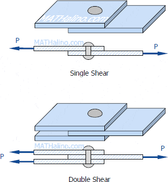

This diagram may be a better illustration of the nature of shear:
Examine the diagram titled 'Single Shear'. Without getting too complicated in the description (and ignoring other forces at work here), the rivet shank (the circular bit connecting the two heads, top and bottom) is said to be undergoing pure shear at the plane where the two plates lap together. The upper portion of the rivet wants to move to the left, while the lower portion of the rivet wants to move to the right, under the action of the forces P as shown.
Unlike axial tensile stresses, which are constant over the cross section of the member, the shear stress in the rivet shank is distributed in roughly a parabolic fashion across the circular cross section.
These concepts of axial loading, shear loading, and bending loading, are usually presented initially in a highly idealized fashion for instruction purposes. In real structural situations, all three types of loading can be present simultaneously to some degree.

In SteamKing's diagrams, there are other stresses acting as well as shear stress, but if you want to decide what size the rivet should be, the shear stress is the critical factor so you ignore everything else. But the other forces and stresses are not zero, just because you decided to ignore them!
Of course the "art of Engineering" is often about understanding what you can and can't ignore in a given situation.
