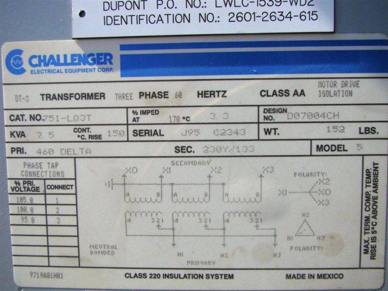

How to know the rating of this transformer
The name plate says 7.5 KVA. That is the rating.

Hello
How the Winding is done in it what is the method
RITESHH KAKKAR said:
Hello
Delta primary, Wye secondary - It’s all there on the plate...
Hello
The Maximum continuous AC Power rating: 7.5kVA
Primary Voltage: 460VAC
Secondary Voltage: 230 L-L; 133 L-N
Can be tapped to provide either: 105.0%, 100.0%, or 95.0% of primary nominal voltage.
Winding Structure: Delta/G-Wye
Percent Impedance at 170 C (normal operating temperature): 3.3%
Insulation class: 220 (220 C will be the maximum winding temperature when in service. Hotter than that and something is wrong.)
Cooling Method: AA (Ambient Air)
Most likely usage: Isolation for an electric motor (hence the strange primary voltage and delta primary winding.)
