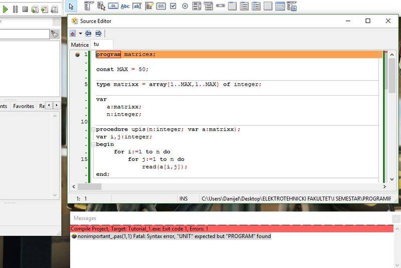

And one other thing, do you know why i can't get this code to actually run in the Lazarus Editor for pascal?
Here is the screenshot:

I think its expecting a unit statement before the program statement.
The screen shot you show is an editor -- you need a Pascal compiler to compile the code and run it.
Likes doktorwho
yeah i got it, the problem was that i was creating a new unit rather than a new program in lazarus.
